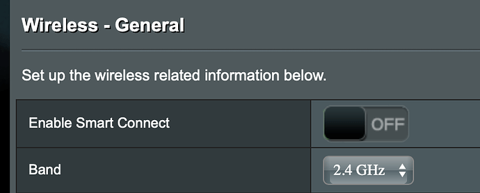

Following up on my post…
I made two changes in my router that appears to have made a difference.
  • Manually set the IP for the HA Voice PE to a static address, and
  • Turn off a “smart connect” feature in my router’s WiFi settings.
It’s been almost two days and historically the HA Voice PE would have disconnected a few times by now - but that hasn’t happened. I’d love to say that I have concrete evidence this solved the problem, but I don’t. It seems to have worked so far though.
What brand router is it and what is smart connect actually toggling? Knowing the brand will help.
My apologies for not adding that. It’s an ASUS ZenWiFi AX, dual unit in mesh configuration with a wired 2.5G backhaul. As I mentioned, I have no concrete reason why this worked, but even as I type now the unit has remained connected without issue ever since. Perhaps the solution was unique to my situation. “Smart Connect” appears to be an ASUS feature that automatically connects devices to the WiFi band that best suits the device’s needs at the time, given some set of conditions. Now, I have two different SSID names for each of my bands (2.4G and 5G) - so there’s no reason this should have worked given the Home Assistant PE only had the 2.4G SSID programmed. But I’m guessing the router may have periodically handed the PE off to the other band and the PE couldn’t connect and instead just dropped.
