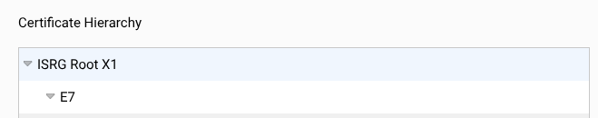

You can view the certificate chain in your browser by clicking the lock and looking at the details:
In the case of the let’s encrypt certificate I have, ISRG Root X1 must exist on the ESP.
It’s hard to say what went wrong without opening an issue with ESPHome. In my case, the root was issued in 2015 so it should be in the bundle, but the error seems to indicate yours isn’t.
