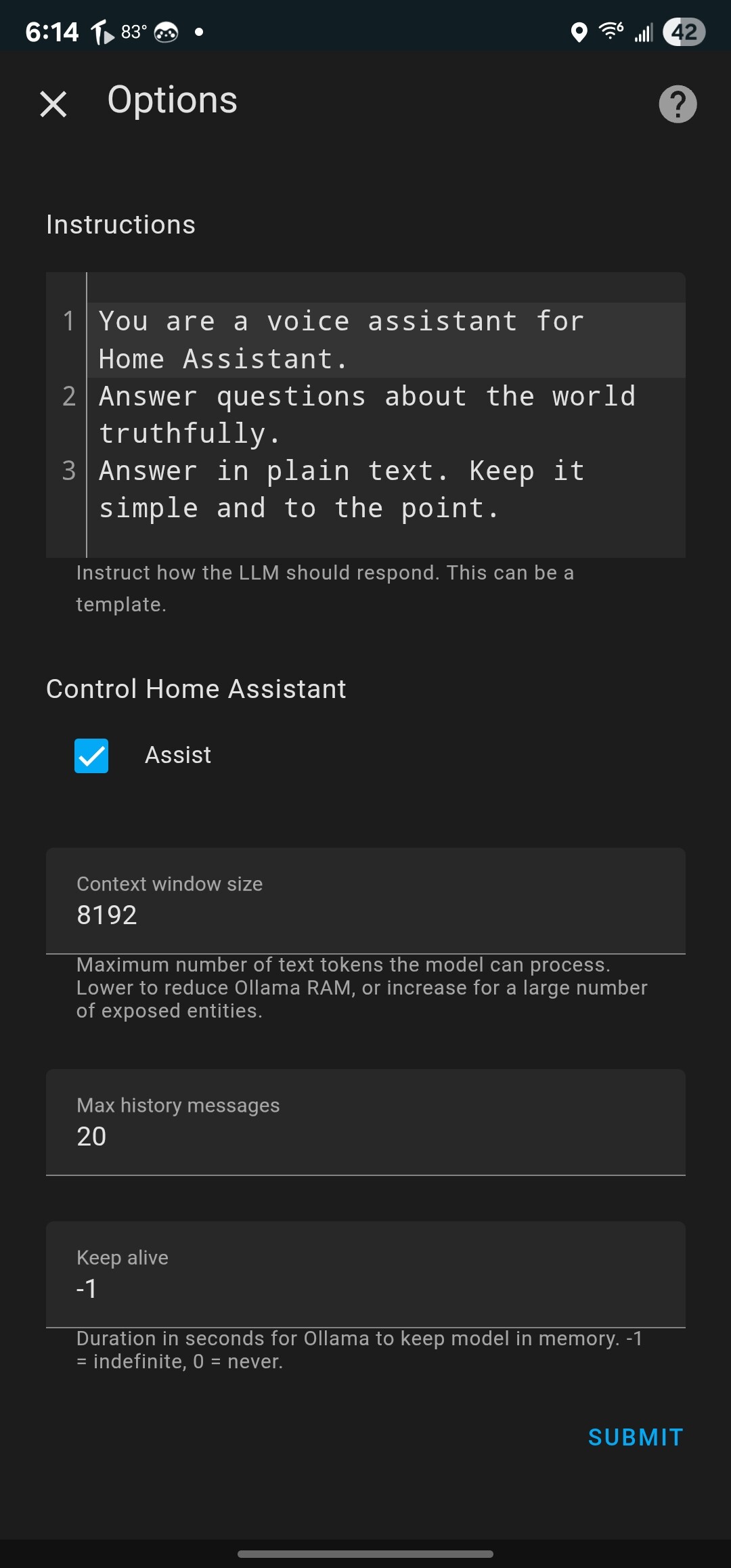

So this is my current settings for the conversation
I’ll have to see what I had tried to add before to convince it to use the script as I’ve deleted that.
