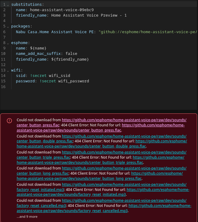

I added the Voice Preview device to ESP Home Builder and it seems that it freaks out because the firmware on github is no longer avaiable. Let me know what you did to get around that issue. I see on google AI results that they do not advise you “take control” of the device anymore because of this issue. Here is an image of what I am seeing after I take control.
Github is sick today, don’t read anything about the software into those errors.
