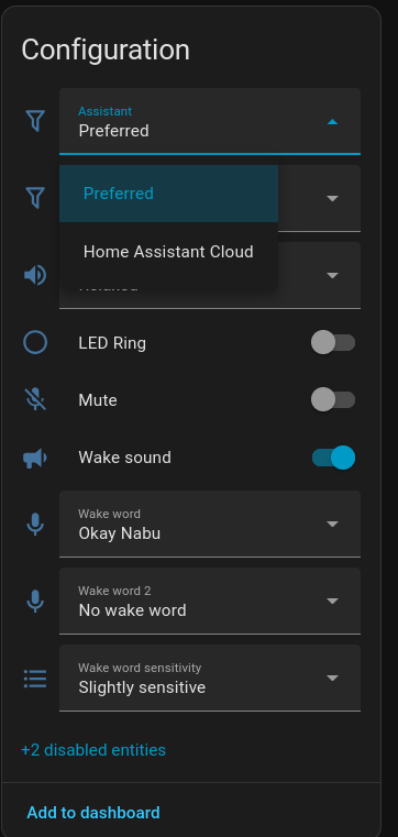

I can see in the configuration, that Assistant and Assistant 2 does not list the internal address. It lists preferred and “Home Assistant Cloud”. Since the “preferred” is set as default and I see these actions, it looks like it’s not recognizing/supporting an internal host name?
Those are the agents you have configured under settings >voice assistants and do jot have bearing on that setting other than if that specific agent is configured for local or remote. You can have multiples configured different ways.
Preferred is ‘whatever you have setup as preferred agent’ in the voice config screen.
The local/network setting is where I pointed earlier and the voice endpoints are directed to whatever is set in local. AFAIK.
