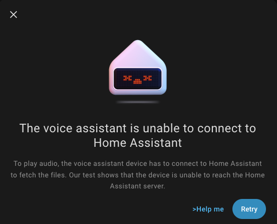

I’m having persistent issues with Home Assistant Voice (ESPHome Assist Satellite) and audio playback (TTS / responses).
During the setup process I always end up with the following error screen:
“The voice assistant is unable to connect to Home Assistant.
To play audio, the voice assistant device has to connect to Home Assistant to fetch the files. Our test shows that the device is unable to reach the Home Assistant server.”

Home Assistant Voice 0a5988: [E][component:362][HTTPRead_0]: http_request set Error flag: unspecified
Home Assistant Voice 0a5988: [E][http_request.idf:128][HTTPRead_0]: HTTP Request failed: ESP_ERR_HTTP_CONNECT
Home Assistant Voice 0a5988: [E][component:379]: http_request cleared Error flag
Home Assistant Voice 0a5988: [E][http_media_source:111]: Cannot play 'https://ha.intern.domain:8123/api/esphome/ffmpeg_proxy/6e5688c690fb55afd85934bf0ff86ad0/tMEc6uiaZLkgD020lyfPvg.flac' on pipeline 0: pipeline is busy
Home Assistant Voice 0a5988: [E][speaker_source_media_player:437]: Pipeline 0: Failed to play URI: https://ha.intern.domain:8123/api/esphome/ffmpeg_proxy/6e5688c690fb55afd85934bf0ff86ad0/tMEc6uiaZLkgD020lyfPvg.flac

You’re on the right track, it’s surprising you haven’t run into this with other clients, or perhaps you have.
Your Voice PE will either have to have your personal CA installed or ignore TLS issues. Either way you have to take control of the device with ESPHome so you can edit it’s YAML. Given your constraints there are no other options.

When you adopt the HAVPE [Home Assistant Voice Preview Edition] in ESPHome it will create a YAML configuration file that pulls the YAML from github. So you will still get updates but you will have to manually trigger the update, by clicking “install”, and it will build the latest firmware for you and install it.
I am using a self signed cert and have not figured out how to install it on the ESP32 device. I don’t think it can be done right now. To work around this I have added the follwing to the HAVPE YAML which stops SSL verification.
substitutions:
  friendly_name: Home Assistant Voice <<REDACTED>>
packages:
  Nabu Casa.Home Assistant Voice PE: github://esphome/home-assistant-voice-pe/home-assistant-voice.yaml
esphome:
  name_add_mac_suffix: false
  friendly_name: ${friendly_name}
api:
  encryption:
    key: <<REDACTED>>
# Bypass SSL requests reducing security
# Required to make Media Player work with unsigned certification
http_request:
  verify_ssl: false
