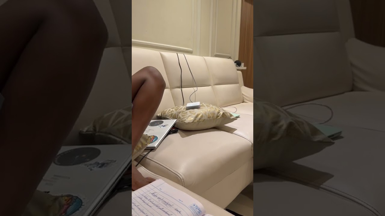

The attached video was recorded immediately after the initial setup and testing, so the hardware placement and overall experience are still very much a work in progress.
