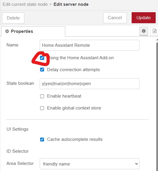

    Every time when I edit the Server configuration associated with the “current state” node (whether you switch to the “Use the Home Assistant Add-on” mode or the “Access token” with correct token), the reading of the “current state” node can be temporarily restored synchronized, but after a period of time (the duration is not fixed), the problem will reappear again.

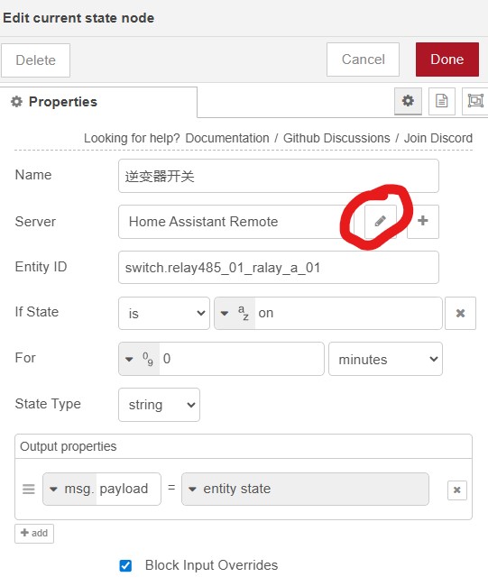

When you click on server, is there more than one entry?
When you click the “+” symbol on the most right of the Server option, you can add another entry. Or when you click the pencil symbol, you can edit the current “Home Assistant” entry. When you go into the entry, there is the checkbox of “Using the Home Assistant Add-on“. By check and uncheck, you can choose whether or not using integrated one or customized one.
How many servers entries do you have in that list? 1, 2 or more?
You should have only one home assistant server config.
Yes, I only have one entry in the dropdown list. What I have done just edit the only one entry by whether or not using the "Home Assistant Add-on".
