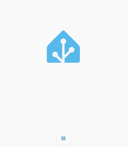

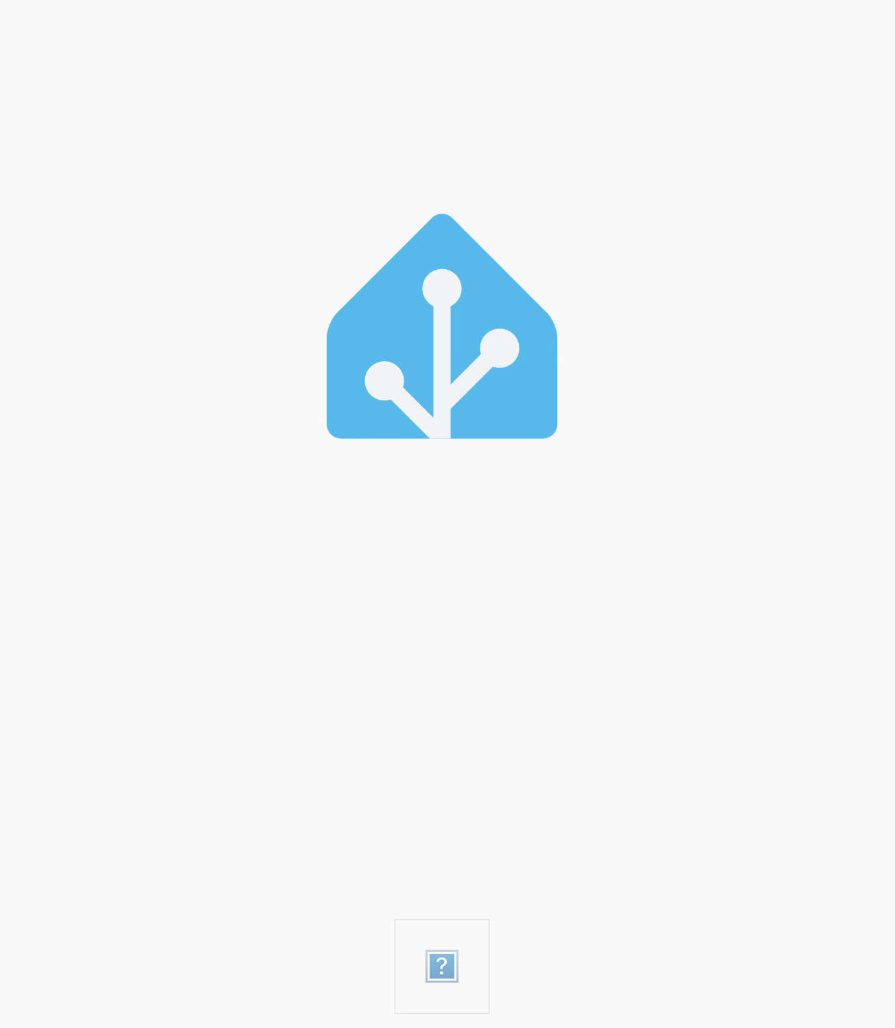

For some reason after upgrading home assistant to version 2025.12.4 and 2025.12.5 my server hangs when accessing it through my external cloudflare tunnel URL. The local IP version works though.
I reverted back to my last save 2025.5.2 and upgraded again but the same thing keeps happening.
I deleted all cache, tried incognito but this issue stays
Does anyone have a solution?
