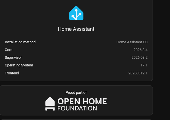

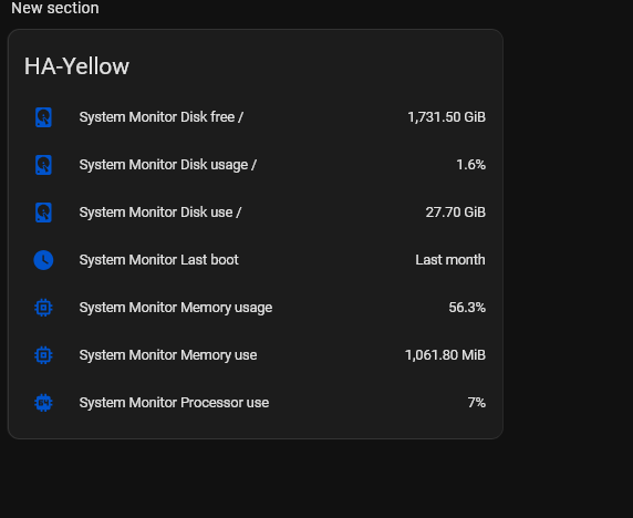

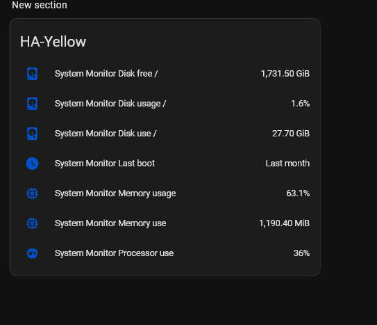

Since installing the 2026.3.4 update my CPU load doubled.
Normally running 5-10%, then to 10-15% and now it is around 30%
First has anyone else experiencing dramatic CPU loads increases?

I found the culprit. Went through the apps and found the eWeLink app (add-on) (the new experimental one that runs with MQTT, consuming a lot of resources CPU and memory. Stopped it, and now back to normal.
