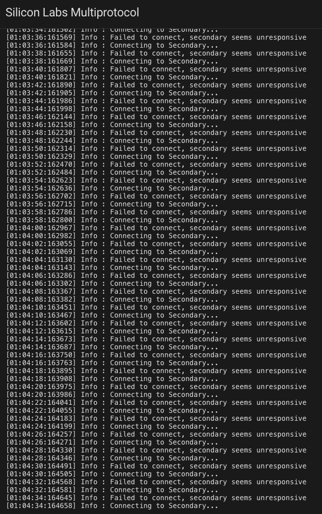

ugh, wish I would have seen this thread before tonight. I was able to successfully get my CM4 swapped for a CM5 variant with more RAM. But alas i’m running into the dreaded Silicon Labs Multiprotocol error and ZHA and Thread are dead.
failed to connect, secondary seems unresponsive
Also seeing this after upgrading to a CM5 today.
Ugh.
Crisis averted. By some combination of resetting the Silicon Labs Multiprotocol add-on to its default settings and shutting down my HA yellow and physically power cycling it, my zigbee devices are back online. Now i’m not going to touch anything…
