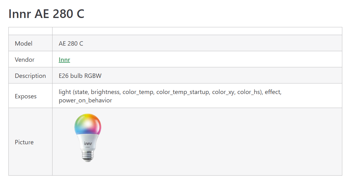

If you check the devices at the zigbee2mqtt website you will see what each device supports. I don’t use Innr devices, but I picked a random Innr one and as shown here it supports “effect” (breathe and so on). You can use that perhaps?

Didn’t even know this existed! Thank you for this!
Ah, okay, yeah, currently using some Aqara T2 bulbs. I have a couple of bulbs to replace, that can be cheap ones. I’ll give them a go and see how they perform. Thank you.
