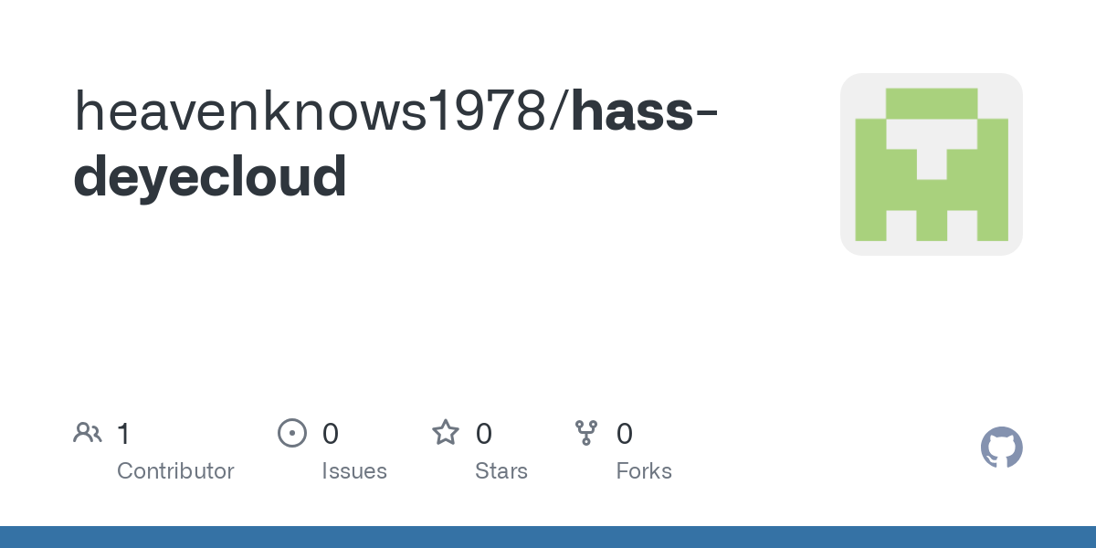

Integration:
GitHub: GitHub - heavenknows1978/hass-deyecloud
