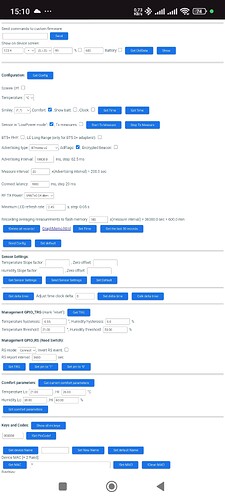

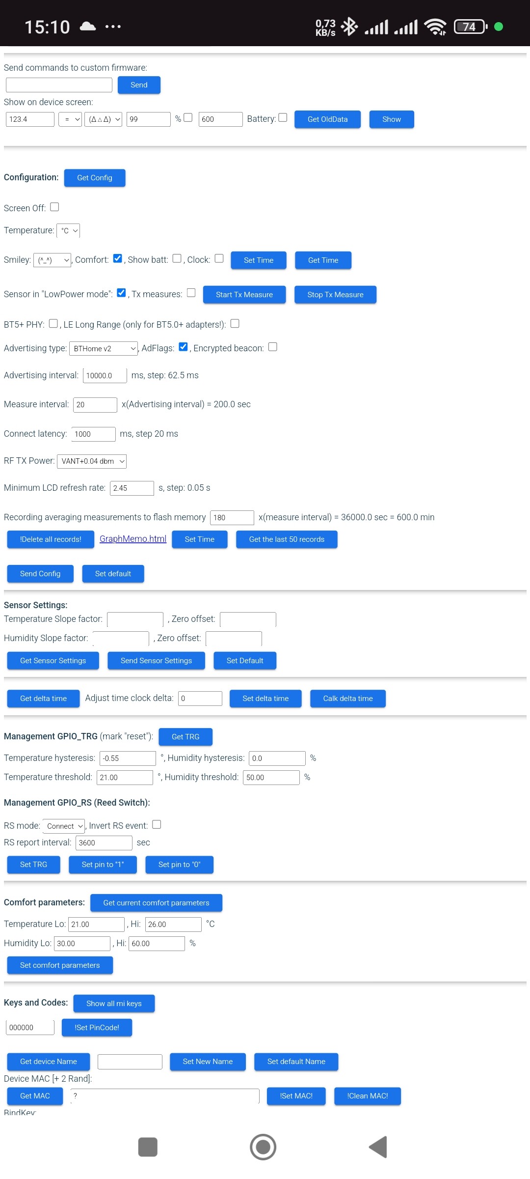

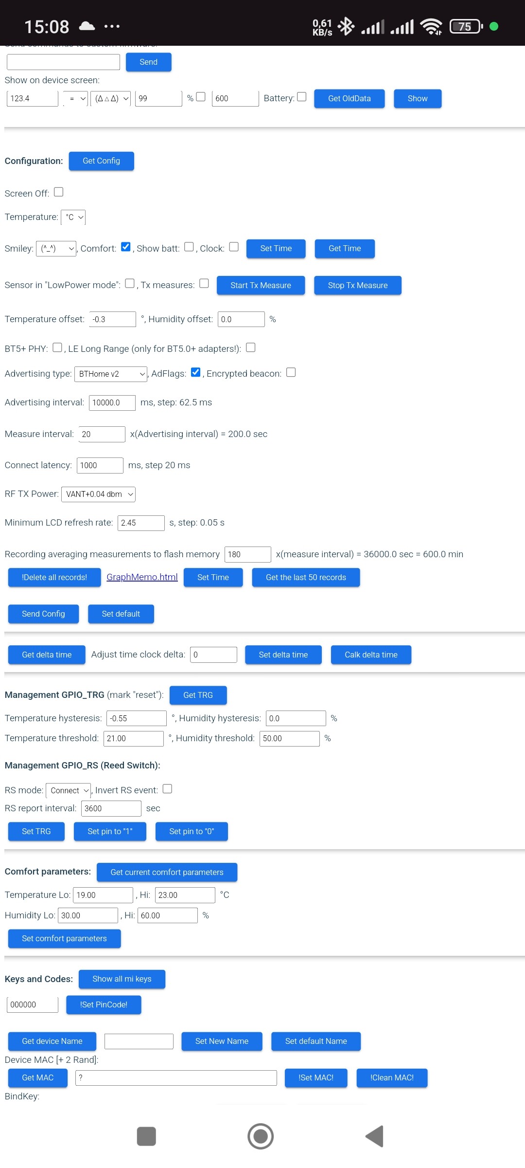

I already had 6 Miia sensors working with the custom FW and recently I adquired a new one to substitute and older and less precise sensor. I followed the process and updated to the last BT Custom FW (5.0) but when trying to calibrate the sensor adjusting the offsets, I cannot find this option in this FW version. How can I adjust the temperature readings in this FW version?
The screenshoots shown in the first post are for older version of the FW
Edit: I include the differents screens I’m getting from different FWs
The first one is from the 4.5 version
The second one is from the V5.0
Sensor settings → Zero offset
Ok, but if I get the values from the device, the original value is -45. Do I have to add my offset to that belt value? Is it in °C?

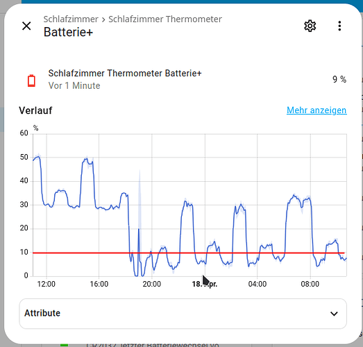

Hint 1: To save cost, Chinese factories try to leave out any component the can get away with (I guess it was a cap in this case), resulting in sometimes flakey behaviour. On some HW revisions, expect a very jumpy battery level indication at battery levels below ~40%.
Also, never try to flash it below said 40% battery level! Always use a (relatively) fresh battery.
For instance, I have my bedroom thermometer ~10m away from the next ESPHome BT Proxy, and it has to go through 3 walls. Below ~30% battery level it starts getting jumpy like hell. I’ve set my “battery low warning level” at 10%, so it gives me many battery low warnings…

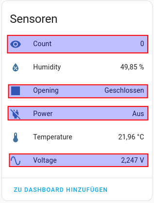

Newer PVVX firmwares (5.x+) added several new sensors. I don’t really know what these are for, and it’s sometimes a little hard following PVVX’s docs.

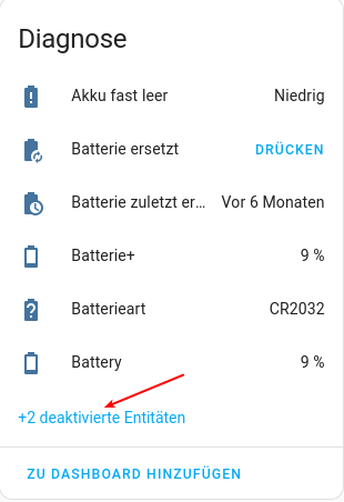

I’d suggest deactivating the following, if you don’t need them. It’ll keep HA’s history database from saving unneeded history data, keep it smaller, and reduce wear and tear.

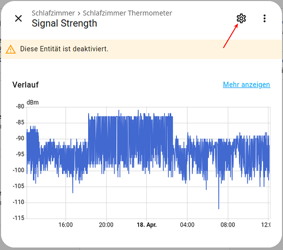

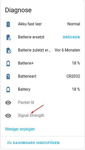

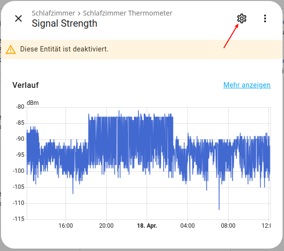

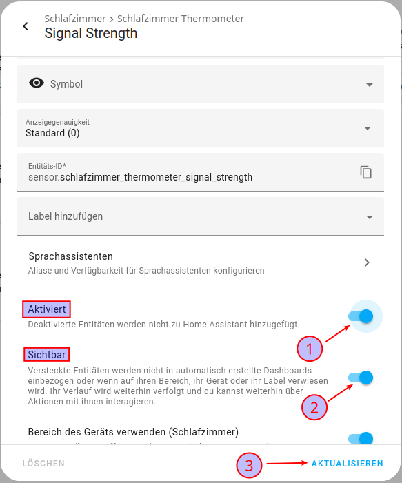

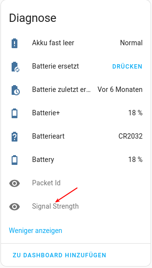

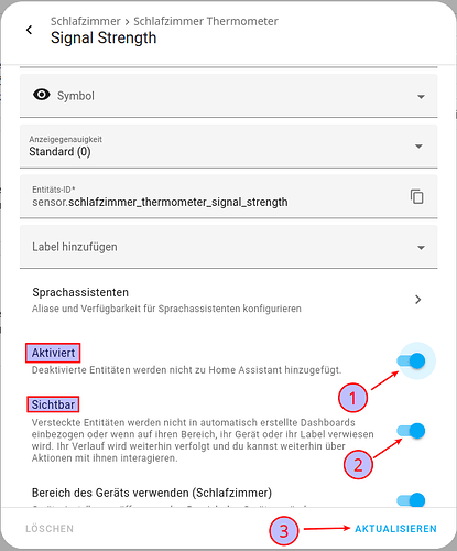

Enable Signal Strength sensor
The signal strength sensor is disabled per default. Follow these steps to enable it (disregard my extra sensors from the wonderful Battery Notes):

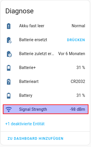

Et voilà! A working signal strength indicator!
Note: It can take up to a few minutes until the first sensor reading appears. If in doubt, refresh the web page (F5 or Ctrl+F5 to also clear the browser cache).
You can use the reverse to deactivate unneeded entities, like those shown in the beginning of this post. Just switch them off.

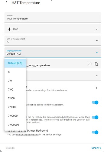

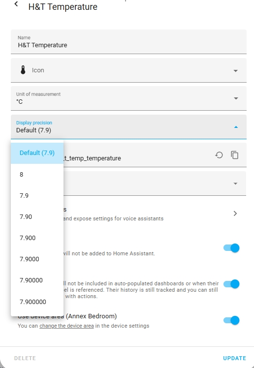

I’m using PVVX custom firmware on LYWSD03MMC. Is there an option to reduce readings resolution to only 1 decimal? Now readings are with 2 decimals
Not within the sensor. Typically you collect data at whatever precision it’s offered, then change the way it’s displayed in Home Assistant.
Within Home Assistant you can click on a sensor and change its display precision. You may need to find the sensor in developer tools.
In HA, yes:
