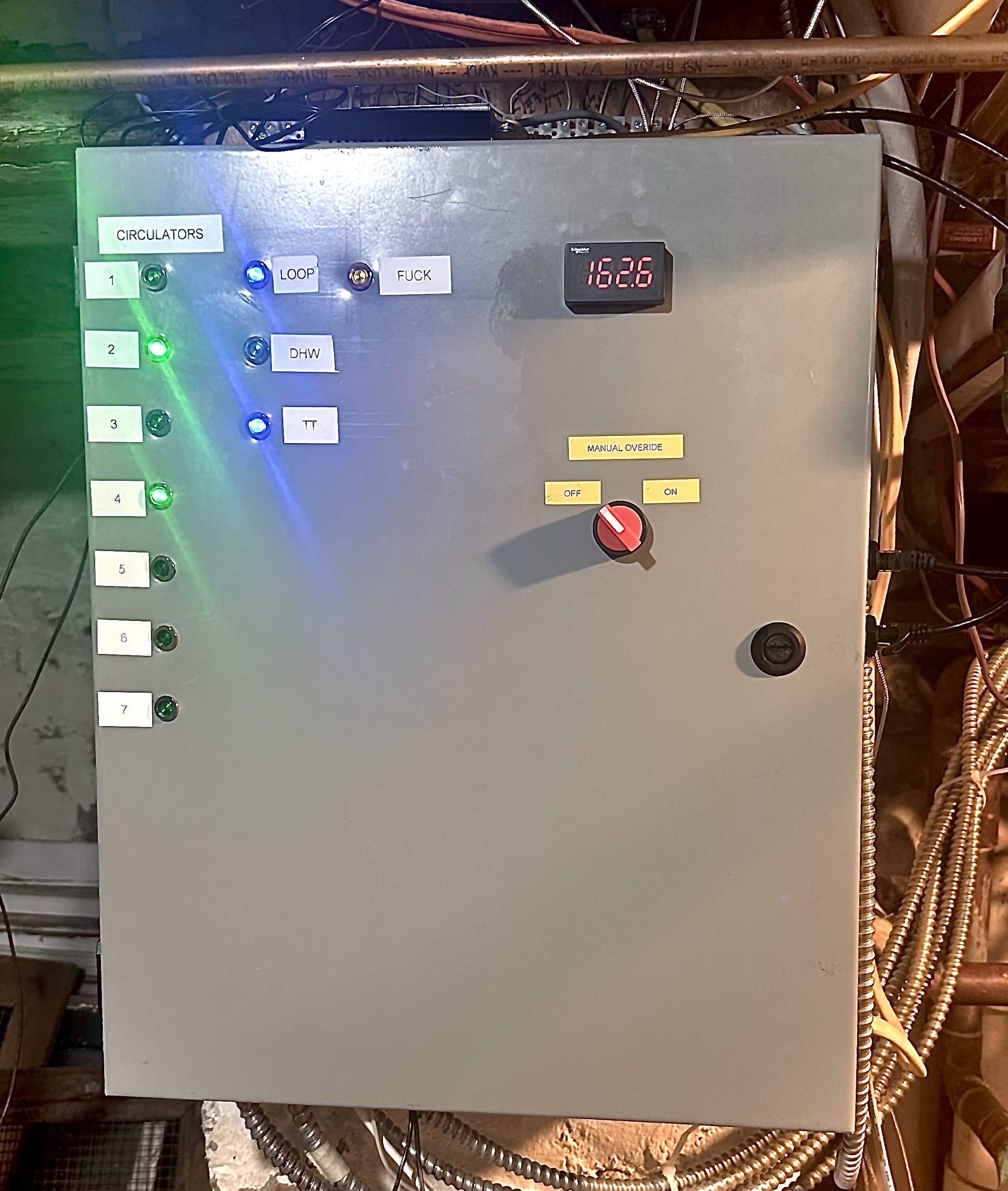

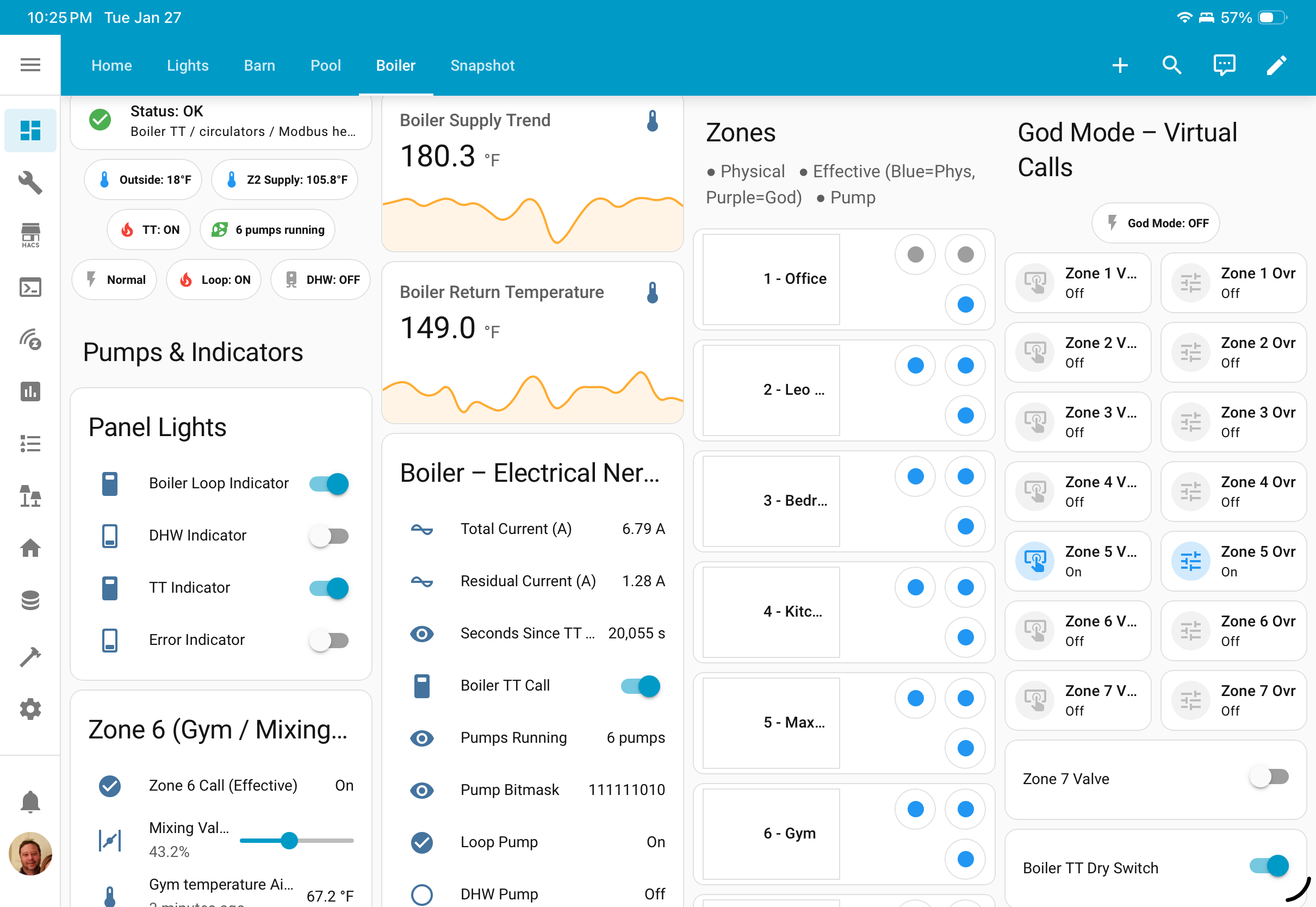

I over-engineered my home hydronic heating system using industrial controls and a “plc like” control system with Home Assistant. This second video walks through the panel with the sensor and other controls and “PLC Like” brain. This is one of many projects I have where I am continue to make my home unsellable in the future.
This project started after 2 years in a row I was skiing out west and we got a deep freeze in the north east with single digit temps. My wife wasn’t all too happy with me, along with frozen pipes I needed to make heating my 200 year old home industrial strength.
Documented in a series of videos walking through how i updated automation and monitoring of my home boiler, the Home Assistant automation, and the “PLC Like” enclosure and controls:

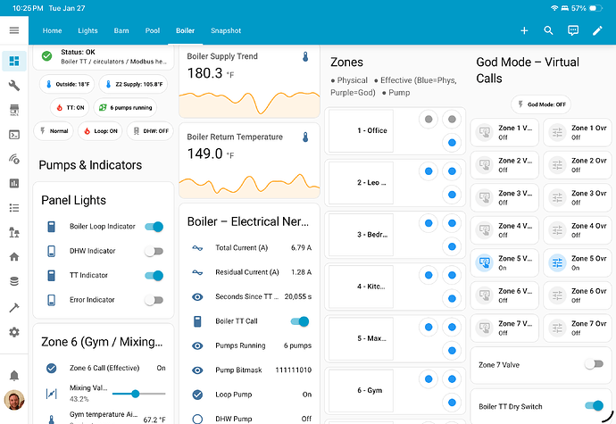

Nice!!! What are the “zones” cards with blue circles in your dashboard? What do they show?
first circle shows if t-stat is calling, second circle is purple if I am in overide mode (I.e. god mode) and last circle is if the pump is running. So I have virtual and effective pump switches….
