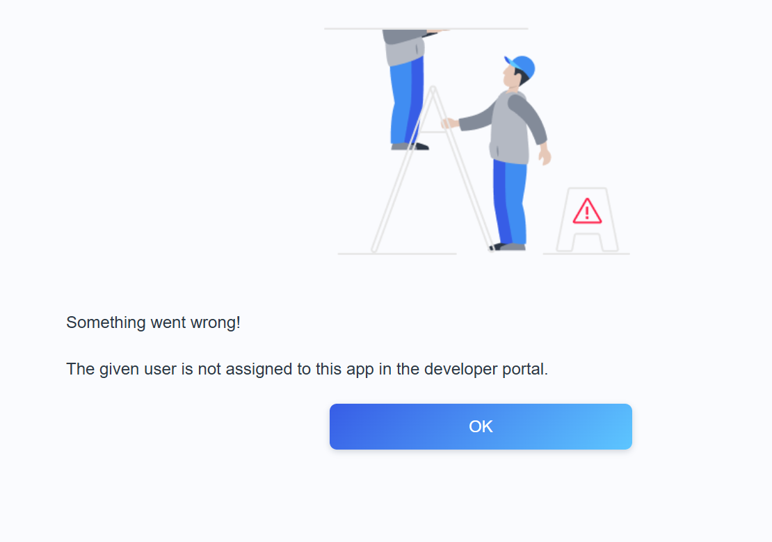

I am trying to configure the Home Connect integration in Home Assistant but I keep getting the following error during the login step:
The given user is not assigned to this app in the developer portal.
I followed the official integration documentation step by step but cannot figure out what I might be doing wrong. I have read other posts that describe this problem nothing seems to work.

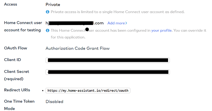

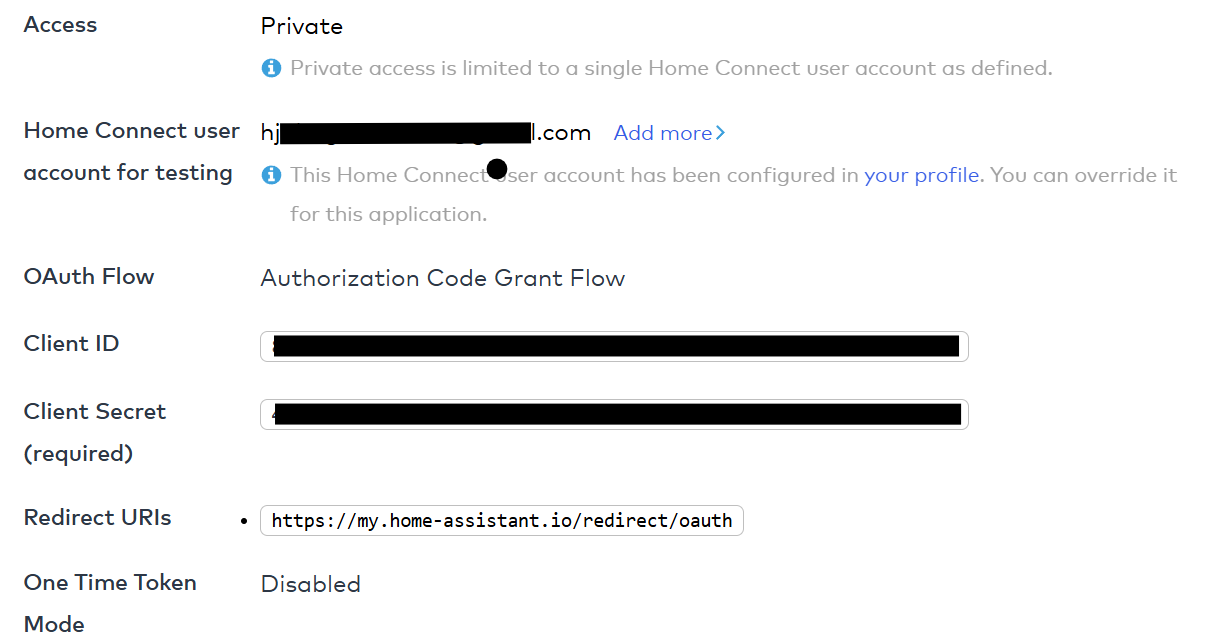

  4. In the Developer Portal application settings I filled in the email address of my Home Connect user account under:
Default Home Connect User Account for Testing
(This is the same account that owns the dishwasher.)

  2. After logging in, I immediately receive the error:

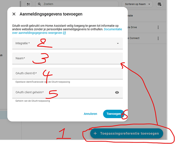

i had similiar issues when adding home connect integration. I have had to add the user credentials manually at home assistant before adding the integration:
http://[your home assistant adress]/config/application_credentials.
There you have to input your home connect developer email, the O-Auth Client ID and Client Secret ID. You find them in the home connect develop portal, where you defined your application
Same here, 2026.3.0
Awesome. This did it. I did precisely what you said. I added my developer email address under the Name field for the application credential and added Client ID and Secret. Then I added the Home Connect integration again. I was prompted to select the correct application credential and then logged in at Singlekey with my Home Connect (non-dev) account, and then I was all set. Thanks a lot!

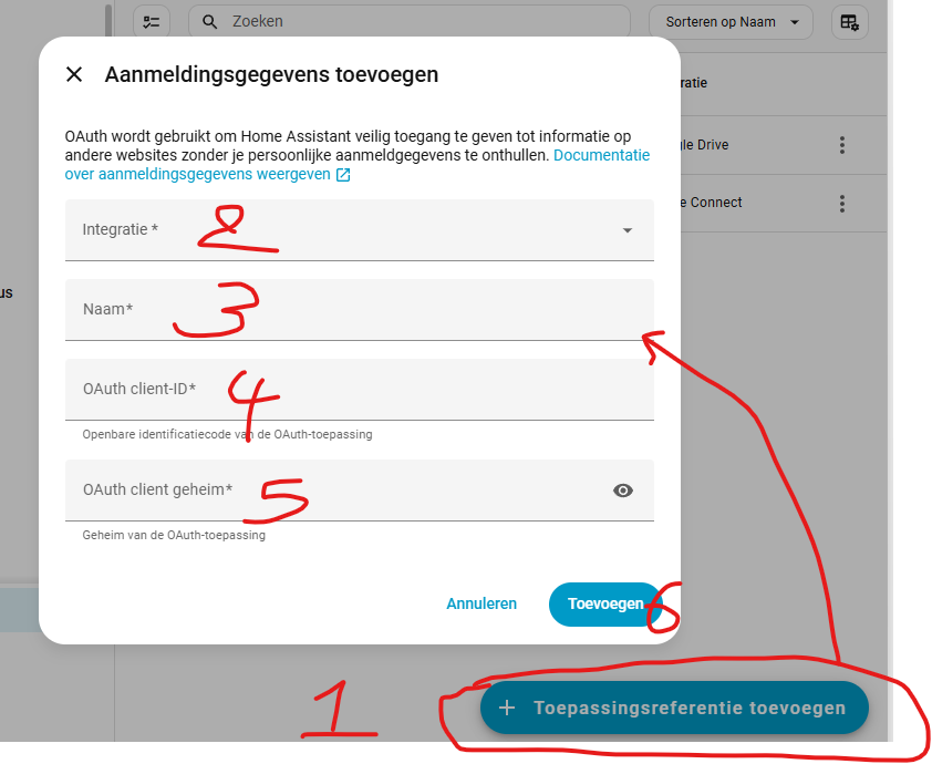

go to the URL http://your_homeassistant_ip:8123/config/application_credentials
Follow indeed the instructions on the integratinon page first.
Once that is done, as an additional clarification to the solution, [quote=“joh-ha, post:9, topic:993625, full:true”]
[/quote]
  1. Click on add item
  2. Choose the integration from the list (in my case ‘home connect’)
  3. Enter the email you used in the developer portal as “Default Home Connect Account for Testing”
  4. Copy the Client ID (found under ‘applications’ menu, click on details on the app you created by using the integration step)
  5. Copy the Client secret (found in same screen as 4 above).
  6. Hit ‘add’.
Proceed by installing the integration from you Home Assistant integration screen…
Unfortunately, I still can't get this to work. I set this up last November and it work perfectly until a good 3 weeks ago. So I tried to set it up again by deleting the integration and its application credentials (via config/application_credentials) in HA. I verified I can log in to the home connect development portal and can see the application details for HA (unchanged from last November), including the email address for the home connect user account for testing (this is different from the email address I use to log in the the HC dev portal and the SingleKey ID website that I get directed to when I try to set up the HC integration again). Then I log out of the HC dev portal, and try to add the Home Connect integration. It prompts me for the name (where I use the "HC user account for testing" email), the client id and client secret. And then it takes me to the SingleKey ID website where I can log in but get the "The given user is not assigned to this app in the developer portal." error. Since that fails, the integration is added.
I tried adding the credentials via config/application_credentials before trying to add the integration. That didn't help (side note: if I add multiple credentials for HC, it prompts me which one to use). I also tried waiting a good 15 minutes, even though I didn't change anything in the HC dev portal (since the app was set up last November).

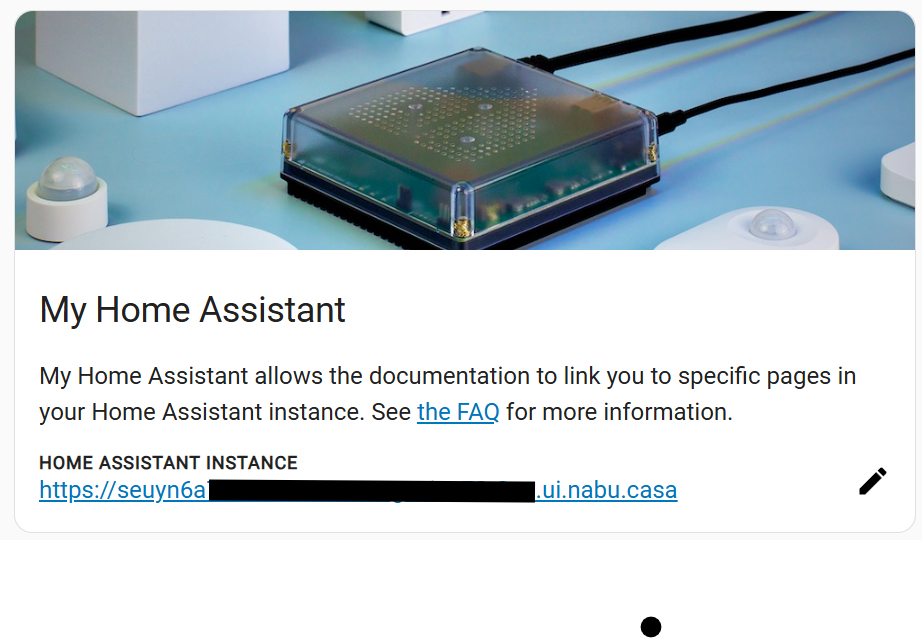

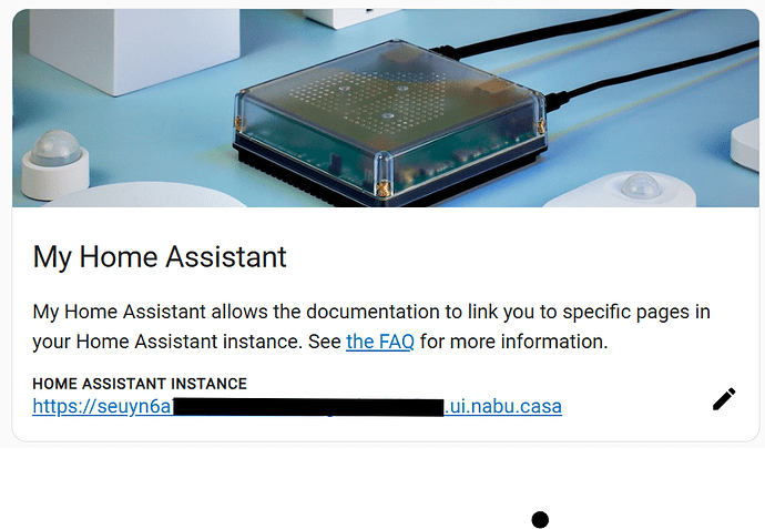

I checked https://my.home-assistant.io/ and the homeassistant.local url listed there does take me to my HA instance (of course only when I'm connected to my LAN; if I try on my mobile phone with wifi off it's not reachable, as it should).
I tried adding the integration via the Bosch entry in the list rather than the Siemens one, but same results.
Also the HC app itself works fine (just reinstalled it on a new phone without issues).
Any ideas on what I might be doing wrong, or what else I can try?
In the above, I should have added I'm on HA 2026.5.4 (and have tried on the HA versions since 3 weeks ago). In the HC dev application setup, the redirect url is set to https://my.home-assistant.io/redirect/oauth and when I get the error, the URL lists https://my.home-assistant.io/redirect/oauth/?error=access_denied&error_description=CIAM+migration+failed.+Error+code:+702&state=.... Maybe that "CIAM migration failed" or the 702 error code says something?
