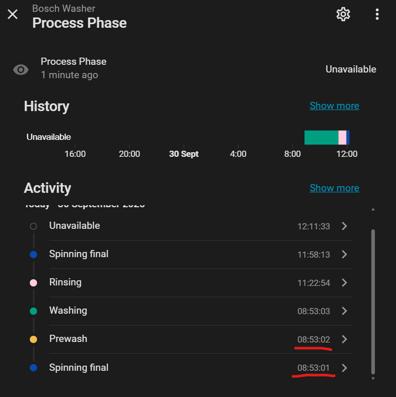

But I noticed this:
Perhaps it’s possible to supress that state if the program progress is unavailable or less than 5% (just to be safe)

Hi @Hellis81
The values come locally from the washer, not from the Home Connect cloud API.
The 1 second “Spinning final” at program start looks like the last phase of the previous run. Filtering by progress would hide real values, so I’d rather find the cause.
Could you open an issue on GitHub with the diagnostics file of the washer and a debug log covering a program start?
Then I can see if the washer sends the old phase or if the integration shows a stored value.
