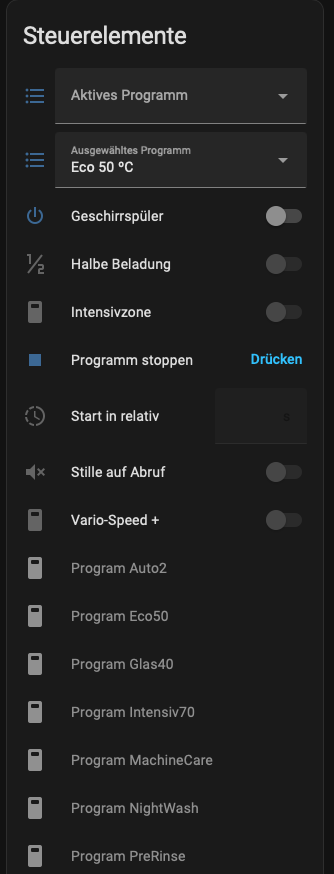

I tried the following workflow:
Turn Dishwasher ON
delay 1 s
Chose Program Eco 50 °C
delay 1 s
Start Program in relative 1 min
But it does not actually start the dishwasher.

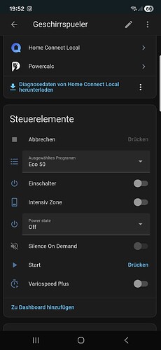

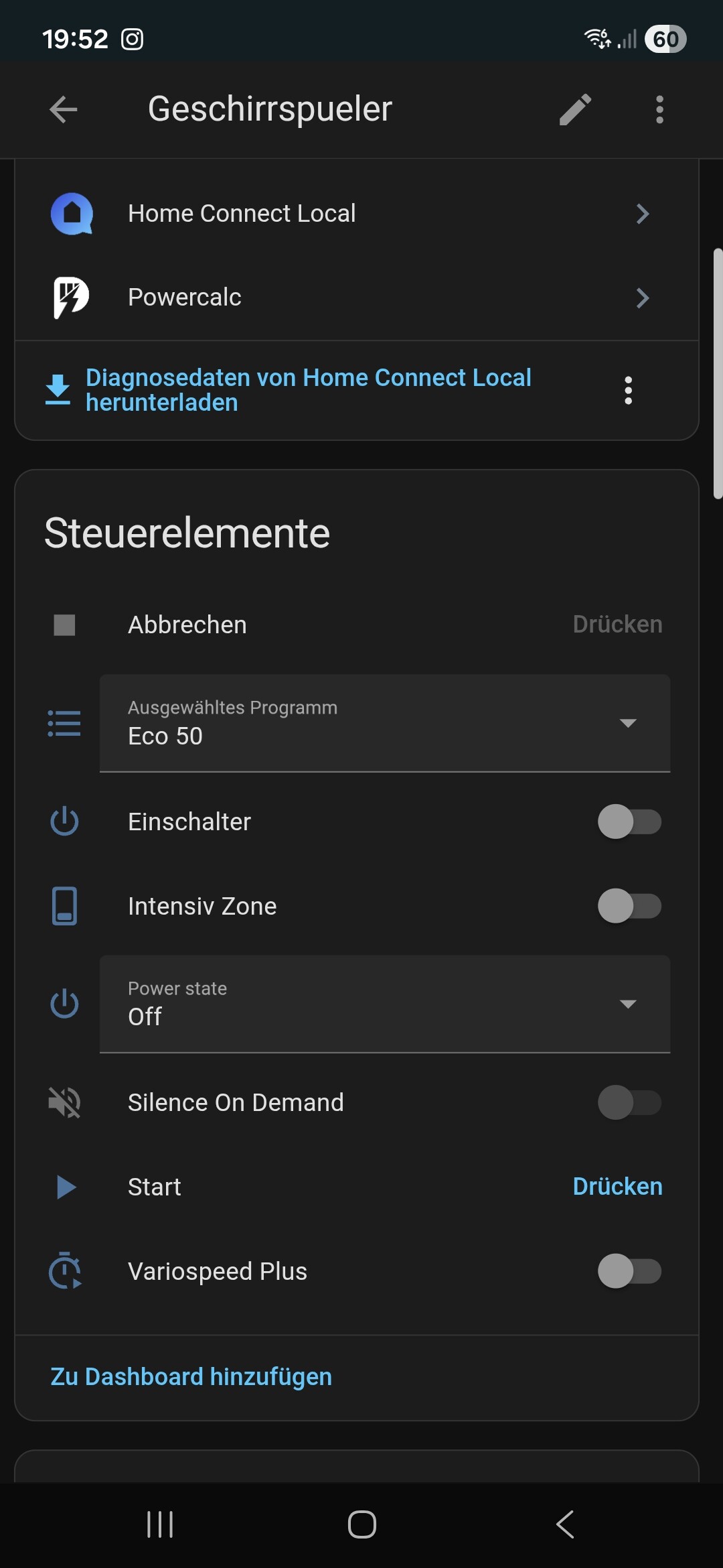

I use Home Connect locally, where there is a start button. See image.
I hope Deepl has translated this correctly.
That indeed, it’s found at GitHub - chris-mc1/homeconnect_local_hass: Home Connect integration for Home Assistant using direct communication over the local network
