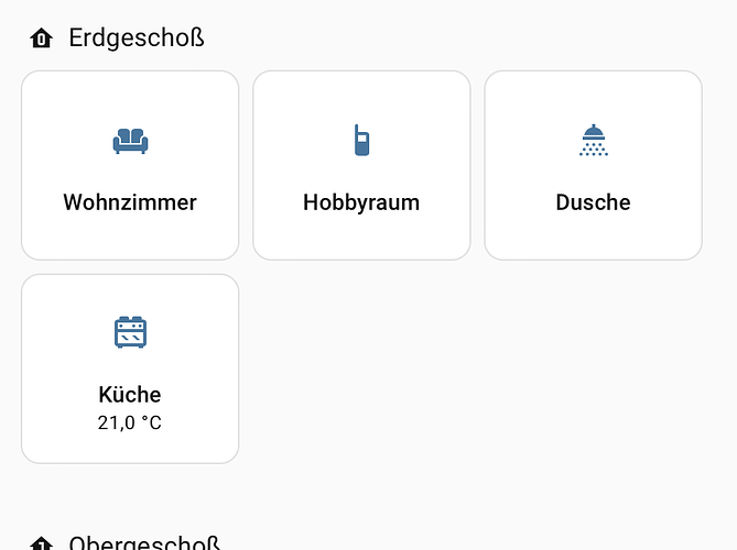

Hi there,
don’t know if this is the right place to post this. But I found that the automatically generated home dashboard show temps and humidity only from a few rooms, about 50%. The rest have temp and hum measurements as well, but don’t get sowed them… Very strange, isn’t it? All rooms in the screenshot have at least temp, some even have humidity measurement.
I have the same problem.
Only 1 area shows the temperature, even thought I have temperature sensors in other areas and they are assigned to the area.
You need to set the sensors in the area itself, which is not the same as setting the area in the temperature entity. That is because an area can have multiple temperature sensors, not all of which may represent the room temperature. My 3D printer nozzle temperature is not the best candidate for my hobby room :wink:
Thank you! I’ve been struggling with this for quite some time. I think when the Home dashboard was first introduced it was automagically setting the sensors, and manually setting the climate settings for the area wasn’t possible. I must of missed when this feature was added.
