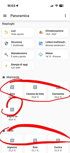

Home dashboard: picture instead icon in Area/Room elements
Is it possible to have the picture of the rooms instead the icon in the home dashboard?

This…

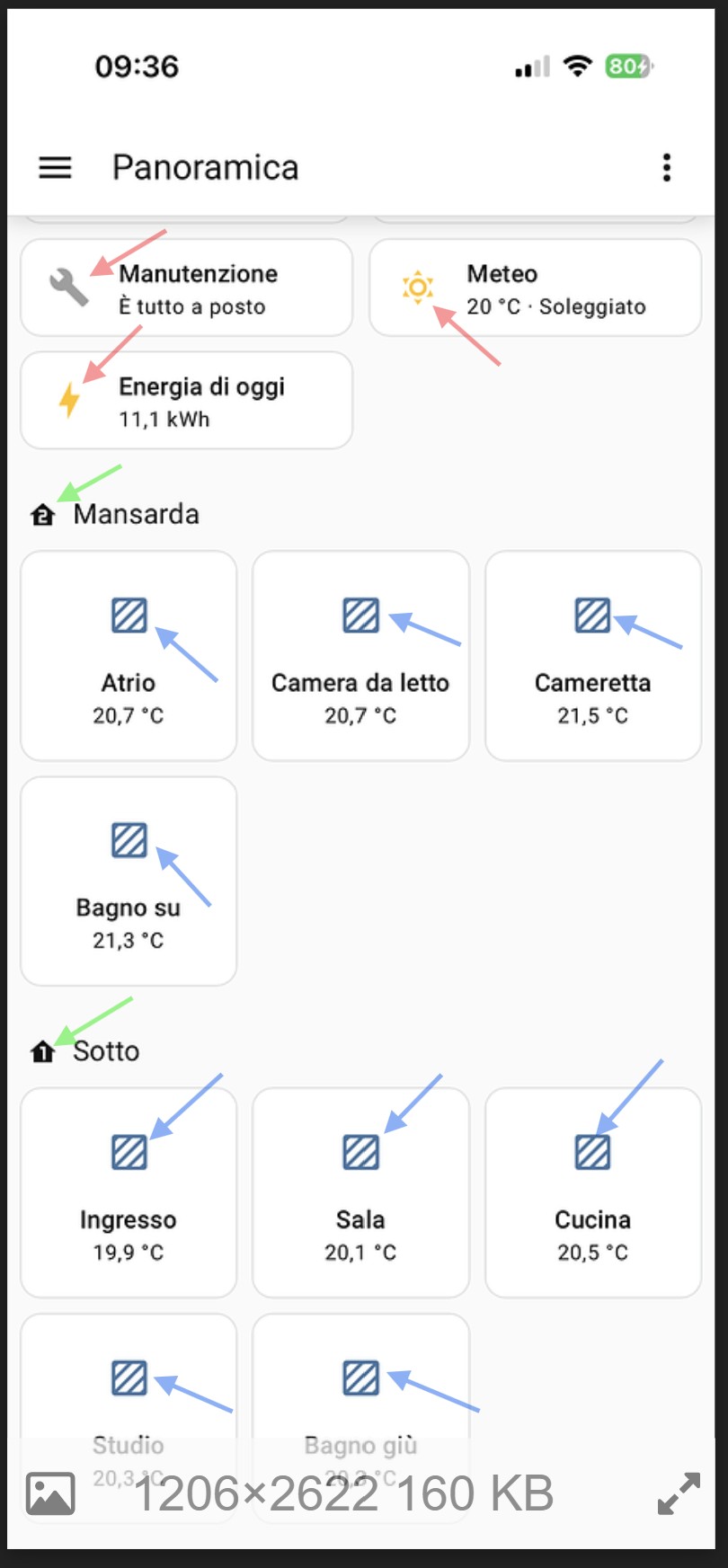

Are you referencing the Area icon?
I do not have a “Home Dashboard” that was created by Home Assistant, so I am not exactly sure what you are referring to. There are also three different sets of icons shown in your screenshot. Are you referring to the ones marked with the red arrow, green arrow, or blue arrow?

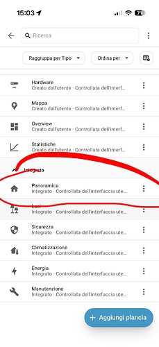

I’m talking about this Dashboard, in italian is named “panoramica” but i dont know the english name :slight_smile: ( I thought “home”)
and i’m talking about this entity, if it is possible to show the area picture instead the icon

We need to get you on the right path for Dashboard builds. You are referencing the Area icons shown in the overview tab. Those can be replaced with other icons, but not pics.
Like LiQuid_cOOled stated, the icons used in those specific types of cards can only be replaced with other icons, not pictures. However, as Arh mentioned, a picture can be displayed in place of an icon or used in addition to one as a background image if you use a different type of card, such as the area card, picture glance card, picture elements card, picture entity card, or custom button card.
