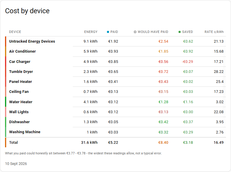

Every five minutes it looks at where the house’s energy came from (grid at the current price, your own generation, or the battery) and shares that cost out across the devices that were drawing at the time. I considered these things important:
  • The figures add up. Anything you don’t track goes into an “Untracked” figure, so the devices plus Untracked always match what the meter says the energy cost. If they ever don’t, a sensor tells you.
  • Battery energy is priced at what it cost to store, not at today’s rate. Charge cheaply overnight and use it at peak, and it shows as the saving it is.
  • You don’t need to track everything. Track two devices or fifty.
What you get
  • Sensors per device: energy used, actual cost, cost at grid price, savings, and the energy split by grid, generation and battery. Daily and monthly totals come with them.

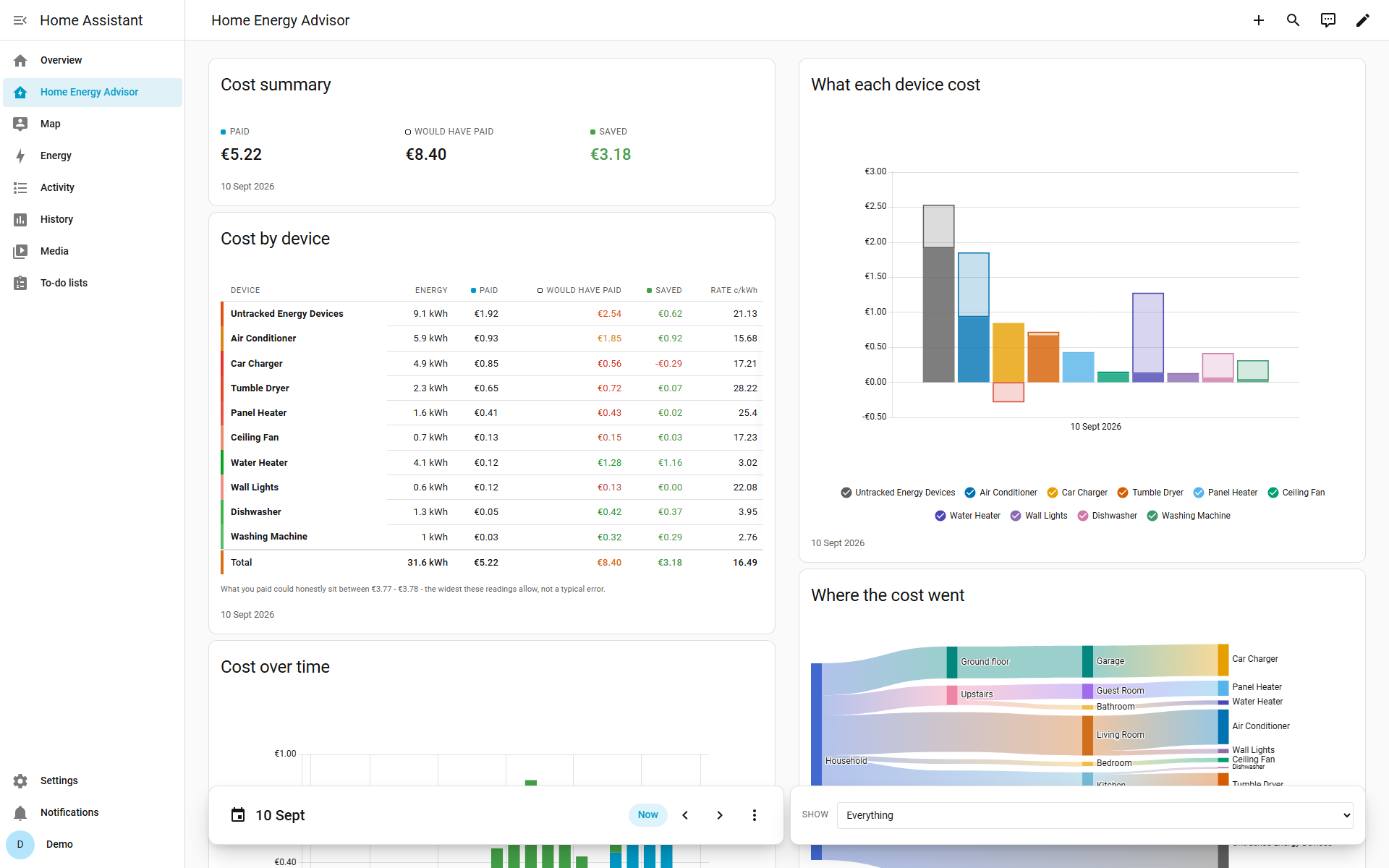

  • A ready-made dashboard (Add dashboard > Home Energy Advisor), plus individual cards you can put anywhere.
  • Setup entirely in the UI. If you’ve set up the Energy Dashboard, most of the house inputs are filled in for you.

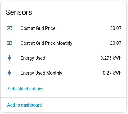

I am, however, having to disable a large number of entities and remove their statistics. Is it feasible to include some kind of setup option for people like me, so that they’re not created (or automatically disabled) in the first place?

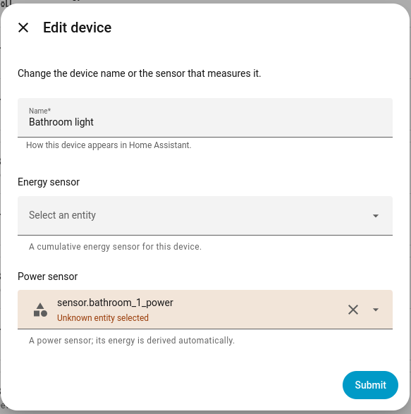

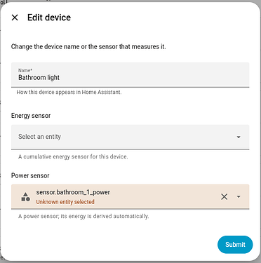

If a power/energy sensor feeding into Home Energy Advisor becomes unavailable for some reason you get a warning in the Edit Device popup.
However, the output entities still have a value - it just stops being incremented - which means that the problem could go unnoticed for some time.
I normally rely on Spook and Watchman to pick up missing entities, but they don’t spot this. A notification would be helpful.

On the unused entities, yes, feasible, and done. Without generation or a battery, five of the seven figures per device can’t tell you anything: two are always zero, and the other three just restate the sensor next to them. Cost at Grid Price is Actual Cost by another name when the grid is your only source, and Cost Savings is the difference between them, so it’s always nothing.
Those are now created switched off, along with their daily and monthly totals. Nothing is asked at setup, if you haven’t told the integration about panels or a battery, it already knows.
One thing to be straight about: **this won’t change your existing entities.**Home Assistant only applies a default like that when an entity is first created, so yours stay exactly as they are. That’s deliberate, I’m not willing to switch off entities someone might have in an automation or on a dashboard.
What it does mean for you:
  • Any device you add from now on will be clean automatically.
  • If you disable the rest by hand, the integration will now tidy up their daily and monthly helpers for you on the next restart. It wouldn’t have before, so that’s worth redoing if you left those behind.
On the sensor that goes unavailable, fixed too, but not the way I said I would, so it’s worth explaining.
The plan was to make our sensors go unavailable along with their source. I decided not to, we can’t tell a broken sensor from a device you’ve simply unplugged, and the second is far more common. Run a radiator all week and then put it away, and what it shows you is right, that really is what it cost. Blanking that figure for the eight months until you plug it back in would be fixing the rare case by breaking the ordinary one.
So instead each tracked device now has a Last Reading sensor, under Diagnostic on its device page. It says when that device’s sensor last reported something we could count, and it goes unavailable once that’s more than half an hour old. The cost figures stay exactly as they are.
That gives you two ways to catch it:
  • Read it. “3 days ago” on the device page, no tooling needed.
  • Watch it. Spook’s unavailable-entity check will pick it up, because it’s a genuinely unavailable entity. Watchman only reports on entities you reference yourself, so you’d want to add the Last Reading sensors to it.
Nothing raises a notification, deliberately, a heater that’s off for the season would otherwise nag you about it every few days until you plug it back in again.
