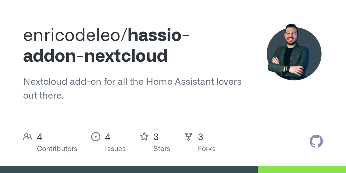

Ok, thanks. A lot to read. Can I use my RaspPi running HA and two USB drives attached, or do I need a separate network attached mini PC (another RaspPi) to run Nextcloud?
The one I linked to is a Home Assistant add-on. You run it on Home Assistant.
It is available as a standalone install if you want to run it somewhere else.
