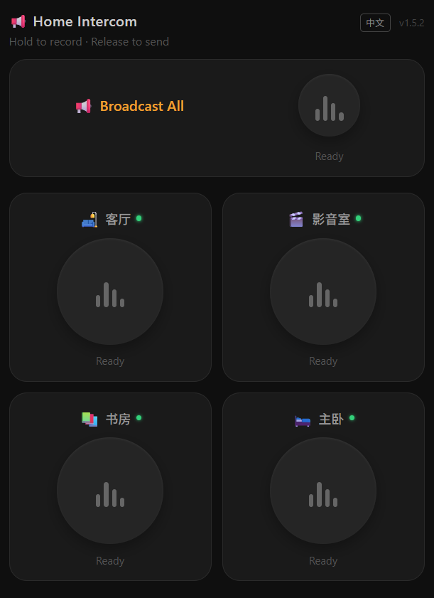

  • :green_circle: Each room gets a card with a big round PTT button. Hold to record, release to play.
  • :loudspeaker: The “Broadcast All” card at the top sends to every room at once.
  • :green_circle:/:black_circle: Each room has a live online indicator — green dot means the speaker is reachable via HA.
  • Recording: button turns green with ripple animation + bouncing sound bars.
  • Sending: green spinner ring around the button.
  • Sent: big green checkmark.

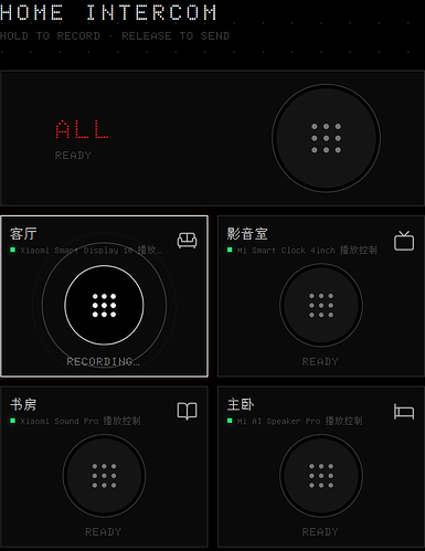

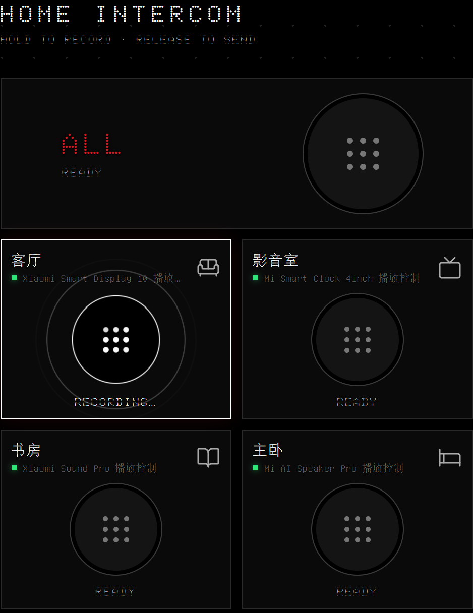

In parallel, I did not pay much attention to the UI. So, I am doing some redesign. @VietNgoc Could you please try with this image: Package home-intercom · GitHub. And provide your feedback here. Here is a preview:
Hi, I can’t seem to load THEME=nothing. But I like the current UI. It’s simple and practical.
Maybe I’d just move the “All” button to the end. I rarely send message to all devices at once.
