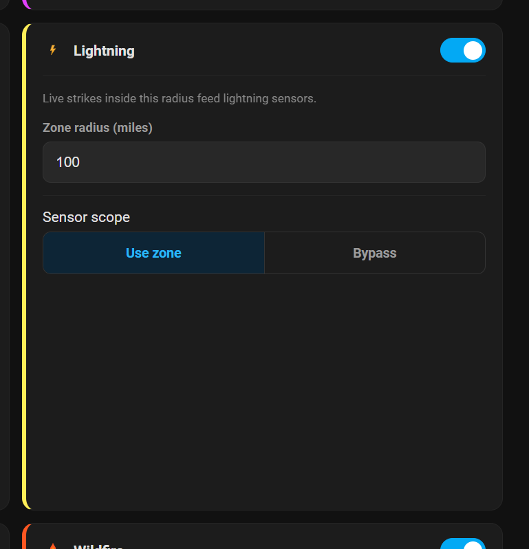

Sorry, unsure what you are getting at, what I meant was I see the integration is currently using Blitzortung for lightning strikes. I currently use this and one of the sensors within it provides distance. When it gets within 10 miles of my home I have an announcement play. I was just wondering if that would be possible with this integration I wasn’t sure how I would capture that in the current configuration or maybe it could be added in a later release.
Set to 10 mi, then create automation for it using the sensors
Was made just for what you described
Ah that’s perfect, I thought that was just for viewing it on the map. I’ll give that a try.
I should of annotated that:
Sensor Scope
Determines the data reported to the sensors in ha, bypass makes it ignore the zone set on map and passes all data. For example bypassing sensor scope for lightning will report all lightning data to the sensor so if the last strike was in California but your in Virginia you’ll be getting that in your sensor lol
Alert Scope
Determines the data reported to the integrations announcement system, bypass makes it announce things outside of the zone.
The scopes are just filters :slight_smile:
Live Data → Zone Filter → Scope Logic
