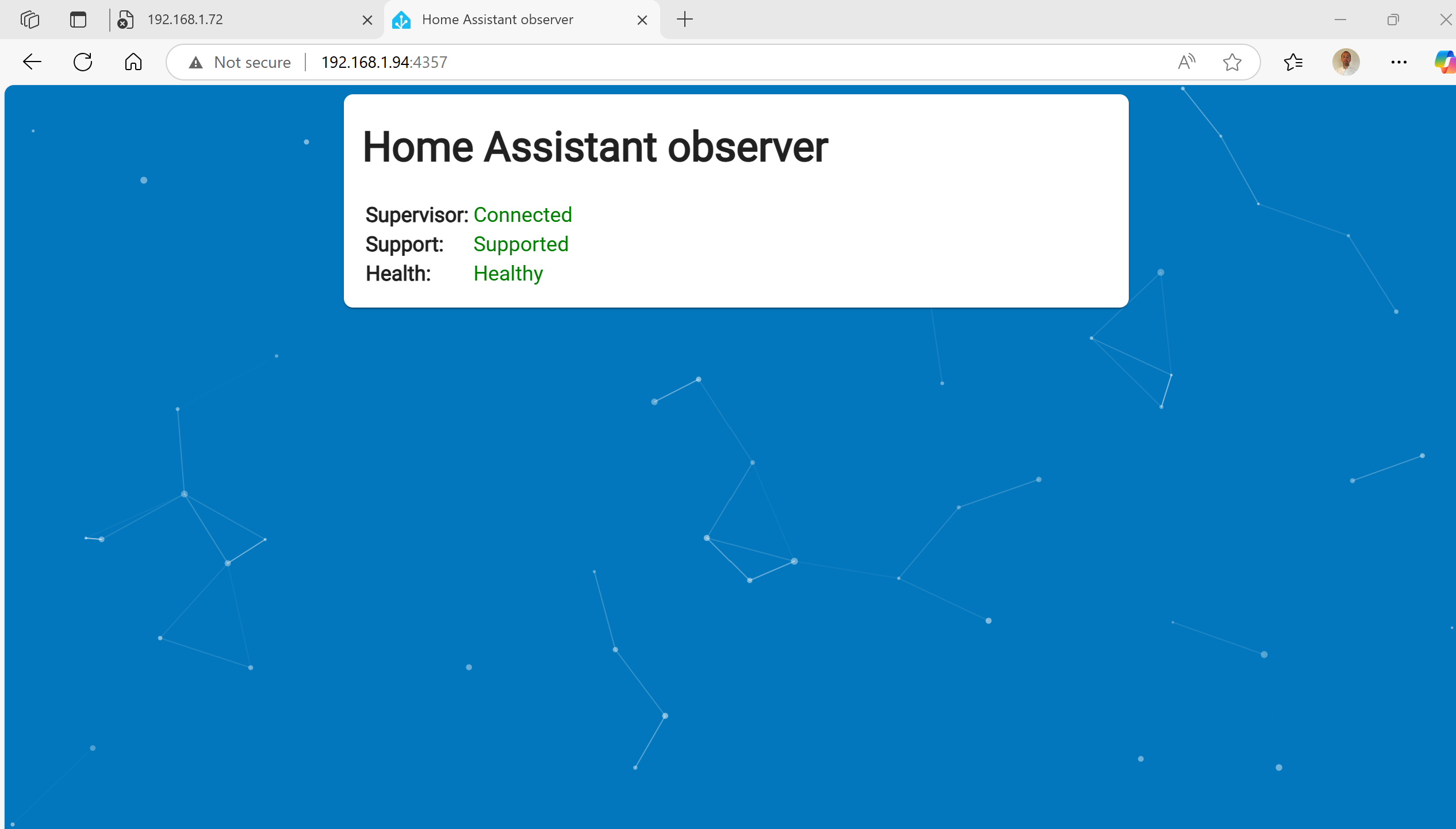

I have a RPi3B, i’ve just download the HA OS 15.2 to my sd.
I’ve connected RPi via Ethernet and i can reach it.
When I open the browser i get
Supervisor: Connected
Support: Supported
Health: Healthy
but i can’t move from this screen on.
Can somebody help me?
Can you attach a monitor and keyboard ?
You’ve found the HAOS observer on port 4567, but have you found the main GUI on port 8123?
A Rpi3+ is right on the edge of what HAOS will run on, so my guess is HAOS has booted but HA is still being downloaded and configured.
My RPi3b+ thest system can take 10minutes just to reboot.
RPi3 is insufficient with moden versions of HA.
For a while there were a warning with a text saying the RPi3 was on the edge, due to limited ram, but lately the warning have been changed to a text saying the RPi3 is insufficient due to ram.
And now the text have been changed to 2Gb ram is required, which RPi3 can not fulfill.
