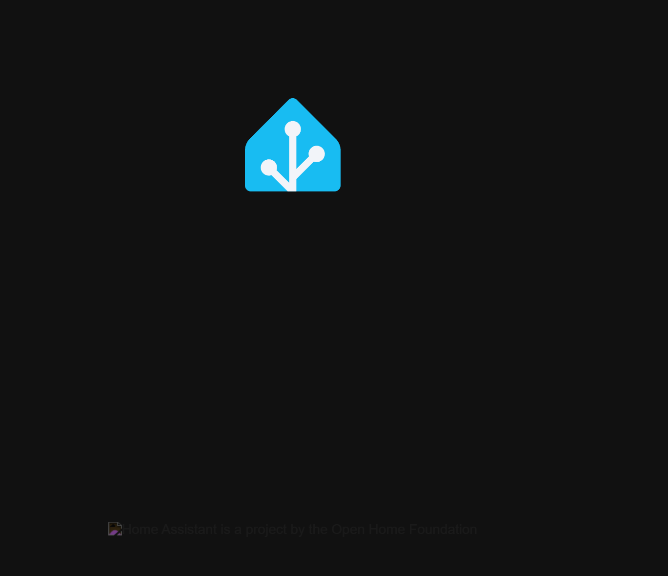

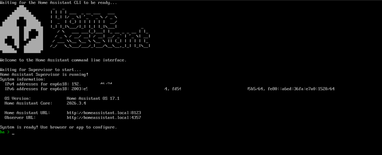

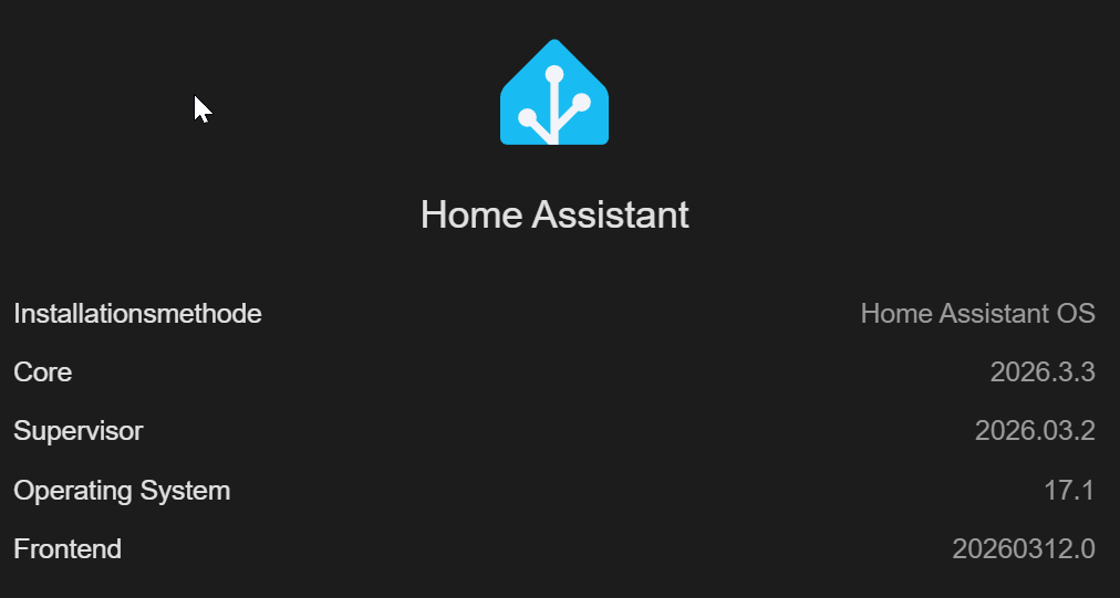

Hey, update to 2026.3.4 runs through.
It works yesterday, but today i have the same issue like before on 2026.3.3
Booting and the start screen looks only like the attached screenshot.
The monitor in my proxmoxve console of ha only shows:

2026-03-25 19:52:46.018 WARNING (MainThread) [aiohomematic.client.json_rpc] [boundary=json-rpc action=CCU.getAuthEnabled err=InternalBackendException: internal error:

my docker ps -a
CONTAINER ID   IMAGE                                                      COMMAND               CREATED          STATUS                    PORTS                                                                                      NAMES
7a15f2f55dcf   homeassistant/amd64-addon-configurator:5.8.0               "/init"               8 minutes ago    Up 8 minutes (healthy)                                                                                               addon_core_configurator
087e51dde1c7   ghcr.io/hassio-addons/vscode/amd64:6.0.1                   "/init"               10 minutes ago   Up 10 minutes (healthy)                                                                                              addon_a0d7b954_vscode
cfa3d4903f0e   ghcr.io/hassio-addons/nginxproxymanager/amd64:2.1.0        "/init"               10 minutes ago   Up 10 minutes             0.0.0.0:80-81->80-81/tcp, [::]:80-81->80-81/tcp, 0.0.0.0:443->443/tcp, [::]:443->443/tcp   addon_a0d7b954_nginxproxymanager
f639e87b063e   homeassistant/amd64-addon-duckdns:1.26.0                   "/init"               10 minutes ago   Up 10 minutes                                                                                                        addon_core_duckdns
3e42aa68a248   ghcr.io/hassio-addons/ssh:23.0.3                           "/init"               10 minutes ago   Up 10 minutes                                                                                                        addon_a0d7b954_ssh
222db630207f   ghcr.io/home-assistant/amd64-hassio-multicast:2026.02.0    "/init"               10 minutes ago   Up 10 minutes                                                                                                        hassio_multicast
91524bd1b60c   ghcr.io/home-assistant/amd64-hassio-audio:2026.02.0        "/init"               10 minutes ago   Up 10 minutes                                                                                                        hassio_audio
2545f81abe9d   ghcr.io/home-assistant/amd64-hassio-dns:2026.02.0          "/init"               10 minutes ago   Up 10 minutes                                                                                                        hassio_dns
a85444c194e7   ghcr.io/home-assistant/amd64-hassio-cli:2026.02.0          "/init"               10 minutes ago   Up 10 minutes                                                                                                        hassio_cli
c4206fab4aba   ghcr.io/home-assistant/qemux86-64-homeassistant:2026.3.4   "/init"               29 hours ago     Up 9 minutes                                                                                                         homeassistant
a3a387c91c11   ghcr.io/home-assistant/amd64-hassio-supervisor:latest      "/init"               4 days ago       Up 10 minutes                                                                                                        hassio_supervisor
b1d73dc08fd1   ghcr.io/home-assistant/amd64-hassio-observer:2026.02.0     "/usr/bin/observer"   5 weeks ago      Up 10 minutes             0.0.0.0:4357->80/tcp, [::]:4357->80/tcp                                                    hassio_observer
looks like only homeassistant:2026.3.4 runs as qemux64-64 version instead of amd64 version of the package.
Maybe this could be a problem ?
Never had any problems in the past 1,5 years - but now with every 2026.3 update expect 2026.3.1
What can i do or is this fixable for other / newer versions ?
Every version debugging is very stressful :smiley:
edit:
Rollback to 2026.3.3 works.
The ui loads again
