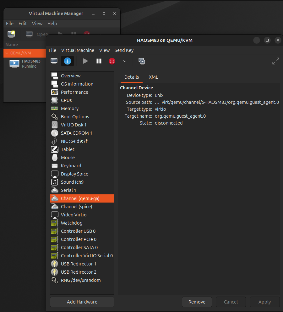

  3. Add Hardware: Channel (qemu-ga):
    which looks like is not working as expected (State: disconnected)

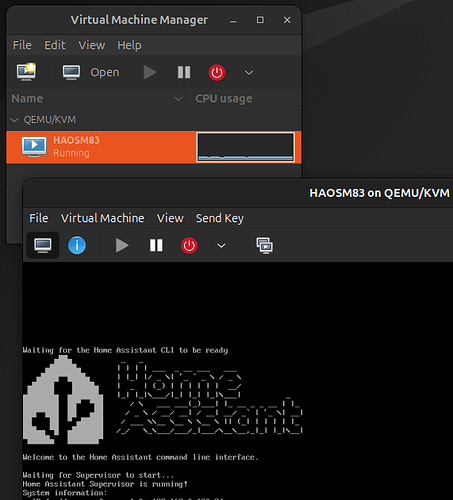

  4. and then I can see the UEFI Interactive Shell v2.2
    • Mapping Table
      • BLK0: Alias(s): PciRoot(0x0) / Pci (0x1F,0x2) / Sata (0x0, 0xFFFF, 0x0)
      • BLK1: Alias(s): PciRoot(0x0) / Pci (0x2,0x3) / Pci (0x0, 0x0)
Even if the Home Assistant VM is up and running, I cannot reach it from the host machine. It seem to be a networking issue.

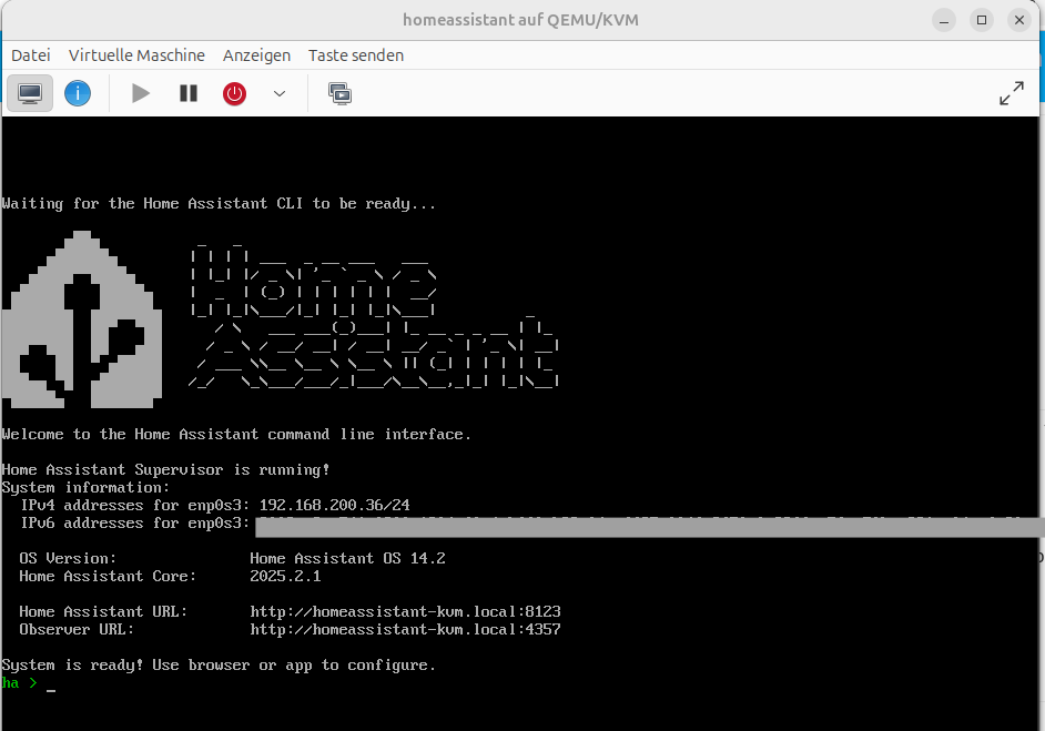

I used the KVM image and it works like in the description. To reach the VM from outside my host system it was necessary to bind the bridge interface to a LAN connection though (see How to Configure Network Bridge in Ubuntu)
In the VM you should see something like
Again, using an old Lenovo Thinkcentre. Have installed from an Ubuntu Flash drive and get to the command line interface as shown above and then the system won’t play nicely. I enter the http://homeassistant.local:8123 which returns an error message unknown command http://homeassistant.local:8123 for ha.
I have also tried to enter the IPv4 address but same outcome.
Help please
Please share a picture of that unknown command output.
You can’t open a browser with that URL on your Thinkcentre, HAOS ( assuming that is the installation method you used) does not have a graphical UI. That what you did, right? At the “ha” prompt you entered this command?
You have use the URL in the Browser of your choice on a separate device ( Windows, Linux, Mac, Mobile, … ) in the same network to finish the installation
