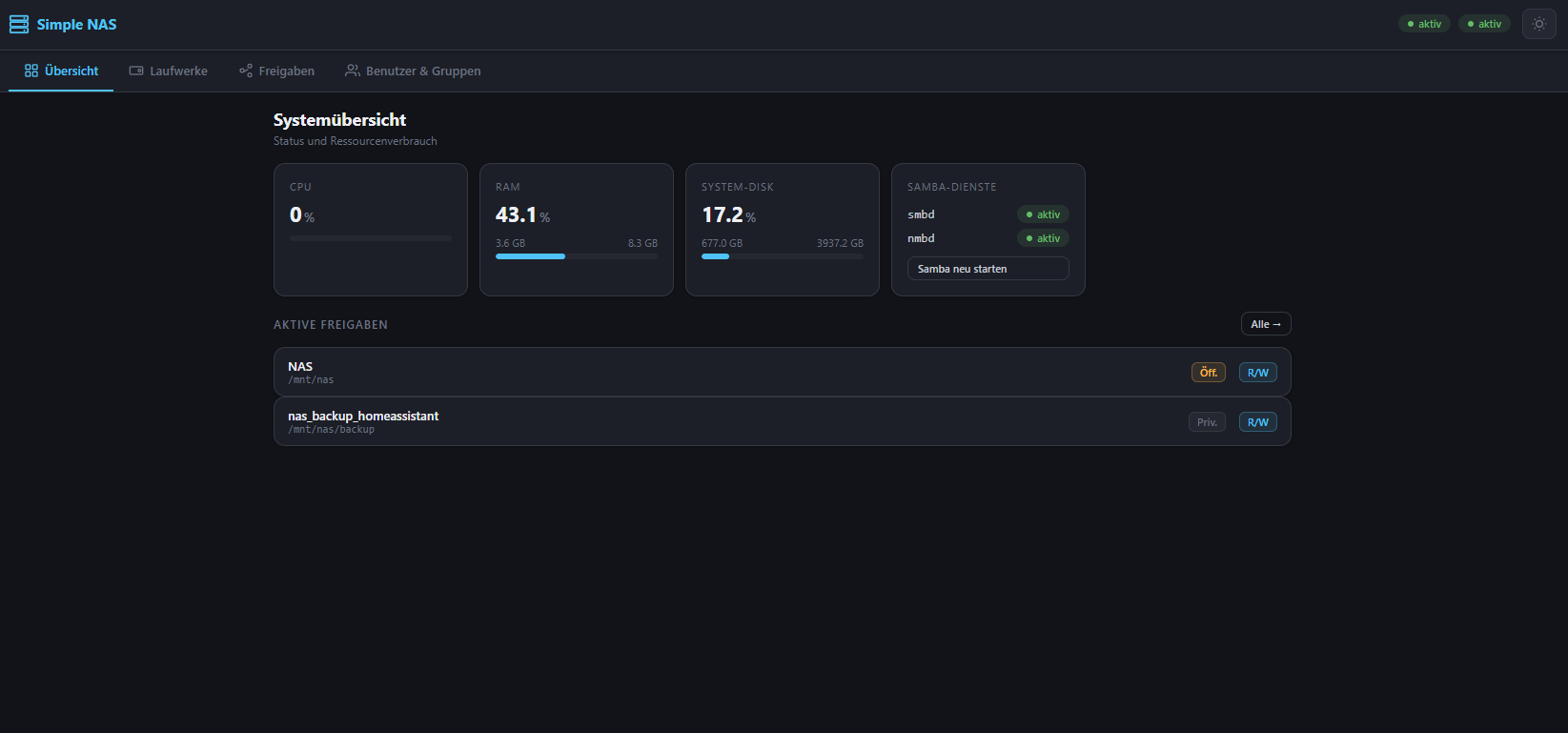

Screenshots

  1. Plug in a USB drive
  2. Go to Drives tab → click Mount on your partition
  3. Go to Shares tab → create a new share pointing to the mounted drive
  4. Go to Users tab → create a Samba user
  5. Access your share from any device: \\YOUR-HA-IP\sharename
