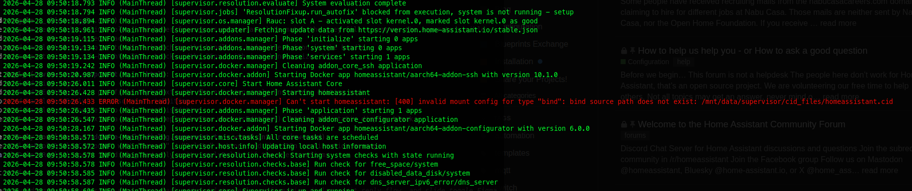

Then on power up home assistant would not start, although I could see my Pi device on the network. After being able to SSH to root and investigate the supervisor container - which was running - I could see there was an error “bind source path does not exist: /mnt/data/supervisor/cid_files/homeassistant.cid”, and the homeassistant container could not be started.
I could see that the file /mnt/data/supervisor/cid_files/homeassistant.cid did not exist on my host, which would be why the homeassistant container doesn’t start. But reviewing the supervisor manager.py source code, I see that this file should be created every time supervisor starts.
