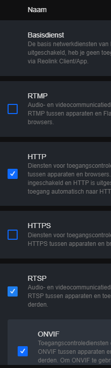

Thanks for the reply, I think I’ve got it now. My Reolink camera works perfectly in the app, but oddly enough, it starts lagging when I view it through the Home Assistant integration and also home assistant istself .that was mine issue when connected with a switch. I decided to try a camera reset to see if that helps, and it seems to be working for now. I’m starting to think I might not have configured the settings correctly before. Right now, I have HTTP , RTSP , ONVIF all turned on. Is there any option I have enabled that isn’t actually necessary ? Take a look at the picture to see my current sellection
