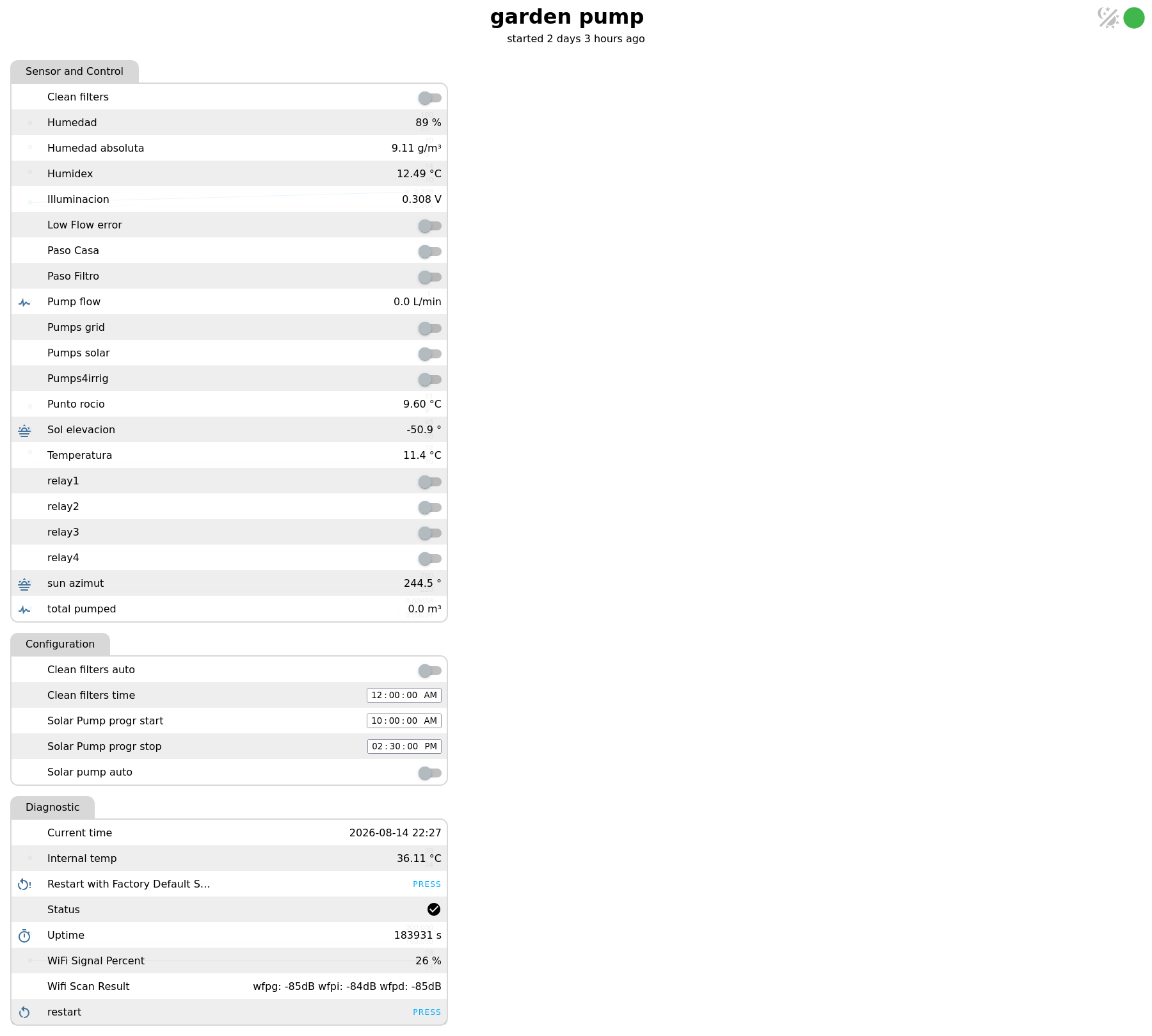

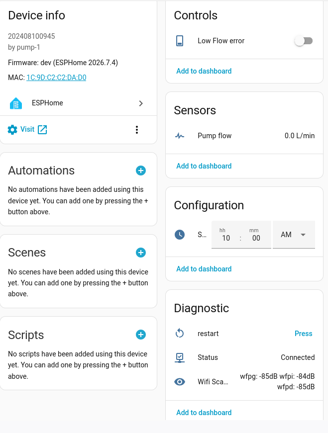

Hi i’m in trouble with esphome and homeassisant .
i thought it was a DB problem but i clean all databases. of homeassistant.
homeassistant 2025.12.5 detect my esphome 2026.7.4 but it appear only some entities not all
If someone can help me :slight_smile: here are some informations

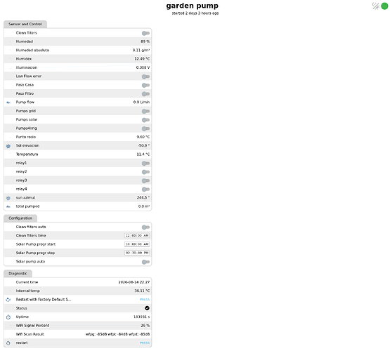

esphome web :
homeassistant for the same esphome
the yaml is :
