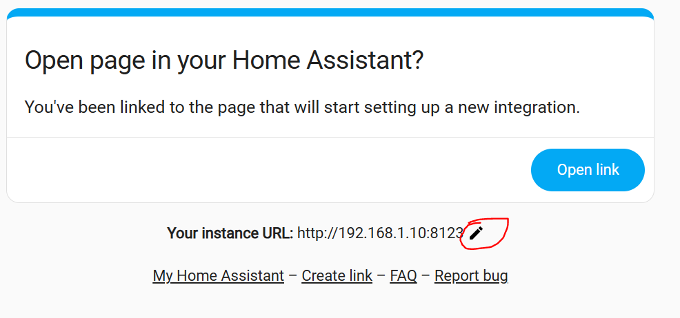

  • Don’t click the MY shortcuts in the docs and instead add the integration manually from the integrations page in HA. Steps to do this are under the Manual Configuration Steps on that page.
  • Click the Add Integration to MY in the docs, then edit the MY path in the “your instance url” page. I just tested the below by changing mine from homeassistant.local:8123 to 192.168.1.10:8123 and it worked just fine:
