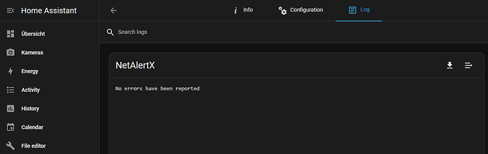

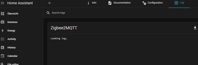

when in a browser (doesn’t matter which) the Logs don’t load.
I can download them, but the screen is stuck on Loading log…
On every App.

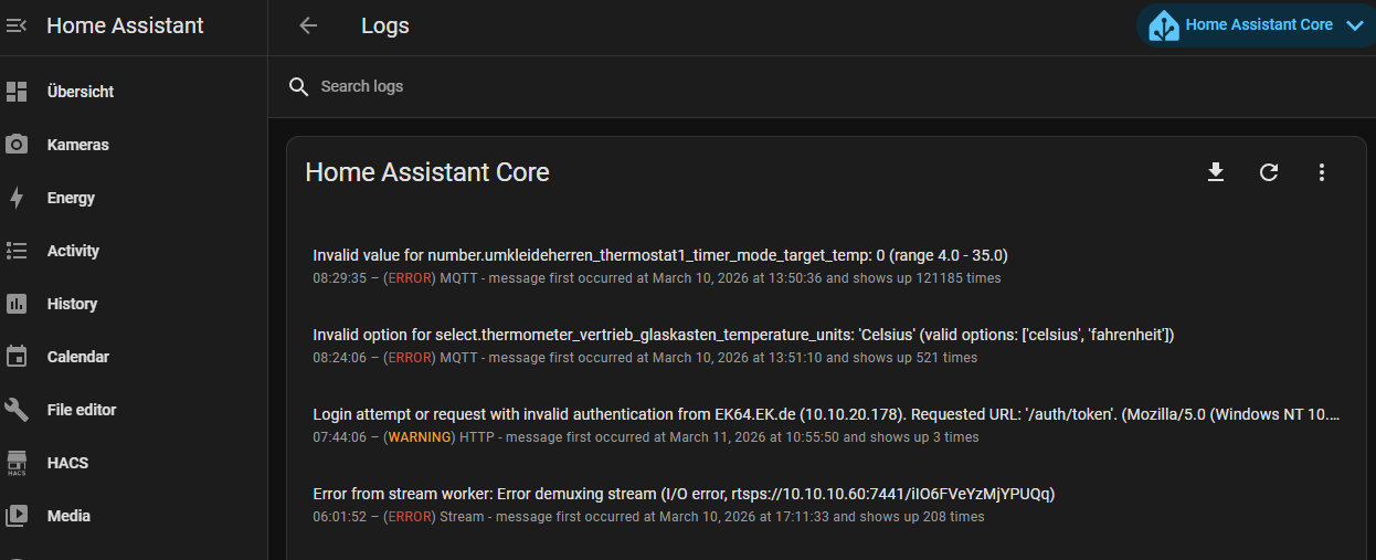

The only log that loads is the core log

This doesn’t help.
I forgot to say that this issue now persists since a few versions back.
It also affects brand new Addons.
I can install one now and it immediately doesn’t load the logs

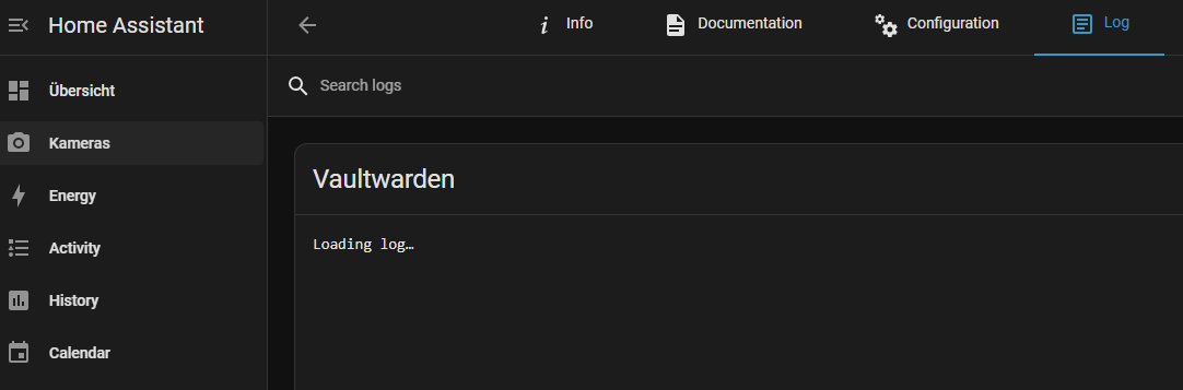

I have the same issue, on all apps, even fresh installs.
Not isolated setup issue.
Issue replicable on incognito browser, and browsers of any device.
Issue prevents app logs from loading and displaying in live stream mode.
*/logs returns the first few lines but are not rendered.
*/logs/follow* does not return any response for up to 4 minutes, until then, no logs are displayed.
Issue happens for apps already running apps.
Issue happens for freshly started apps.
Downloading logs work fine.
I have this exact same issue, and have for a while. None of my app logs ever seem to load.
