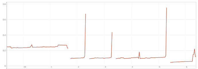

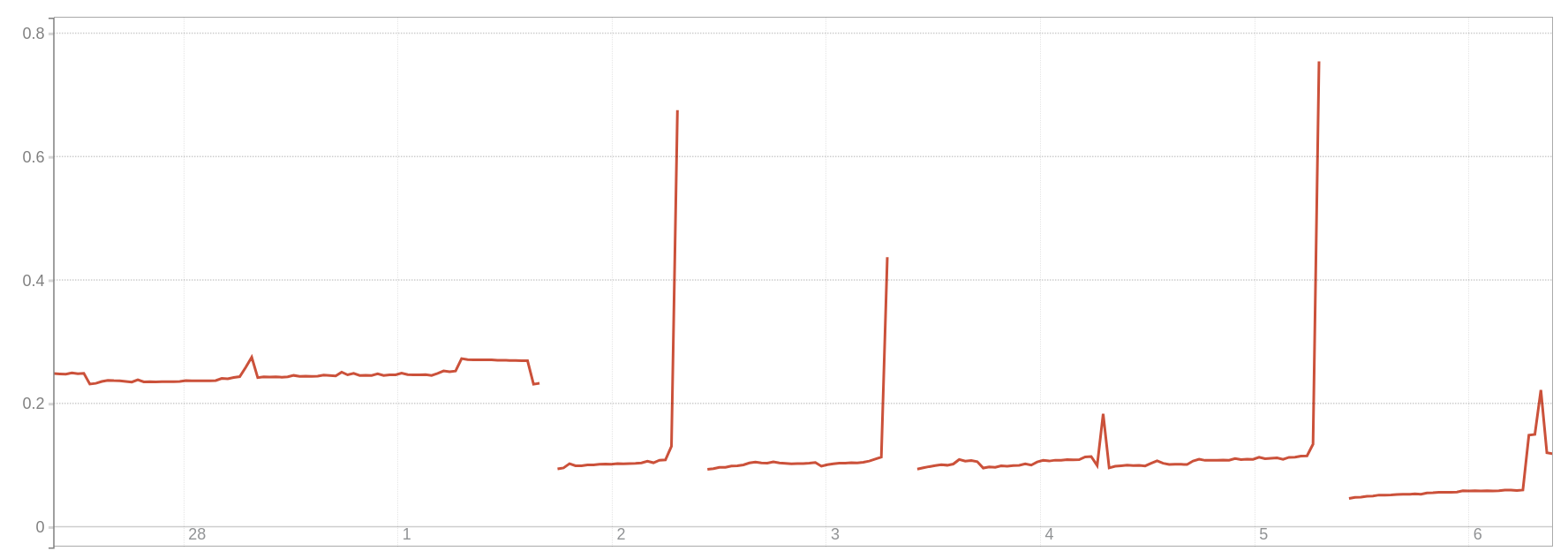

No huge spike this morning so I dug out the monitoring for this host:
So still a spike, just not one that took out the host (you can see gaps previously when the host was so overwhelmed where the gaps are).
Going back in time, there’s always been a bit of above average memory usage at 6.30am every day. It started getting large from the 17th (which was also the first crash).
So this isn’t a new process, just something existing that has suddenly gotten worse.
