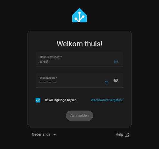

I try to restore a backup on a rapsberry pi5 but takes a long time before i get the login windom and it gets stuck on that.
I tried a backup from last night and a backup from 28 of november. Both have the same issue
