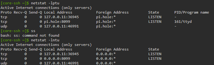

Assuming the request it making it to this machine, I checked which ports HA was listening on:

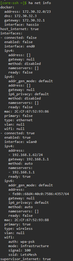

Based on another thread, I also grabbed all the netinfo (which I will post in a reply perhaps because I’ve just been alerted new users only get one media upload per post and the terminal add-on for HA:OS won’t let me copy from it…)

Just in case it’s helpful, here’s the netinfo:

From the command prompt “core-ssh”, you’re inside an add-on which is running under Docker on the HA-OS machine. For your netstat to produce the results you want, you’d need to be on the actual machine, either directly or via SSH using port 22222 once configured. This addon can help with the configuration.
