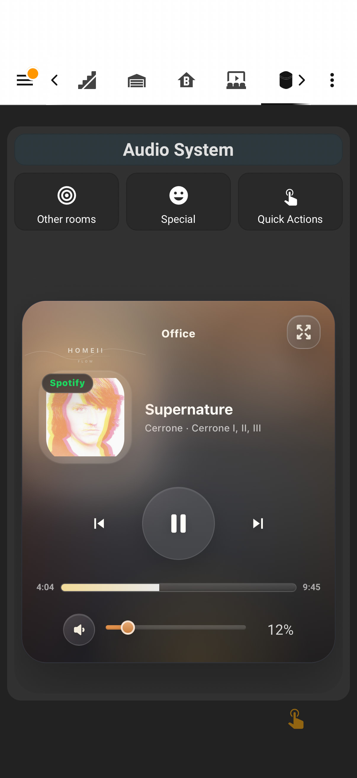

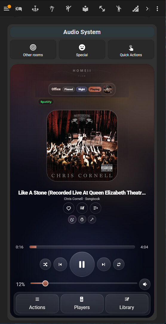

Some questions / bugs on the mobile version (running on iphone17 using ha app). I’d like the page to appear like this on my mobile app (this is from a similarly sized desktop window):
But on my mobi device the compact version always appears:
And when I hit expand, it doesn’t honor the iPhone design layout:
So 1) is there a way to force it to always show the expanded compact mode, and 2) is there a way to adjust the expanded version to render better on an iPhone?
Thank you!!!
Yes, this is something I can address in the next version.
The current auto-compact behavior is too aggressive on the iOS Home Assistant app, because the app can report a more constrained height than a similarly sized desktop window. I’ll add a proper way to force the full mobile layout, and I’ll also improve the expanded compact view so it renders correctly on iPhone screens with the HA app\ chrome and safe-area spacing.
So for now I’d treat this as a card-side layout issue rather than a configuration mistake on your side.

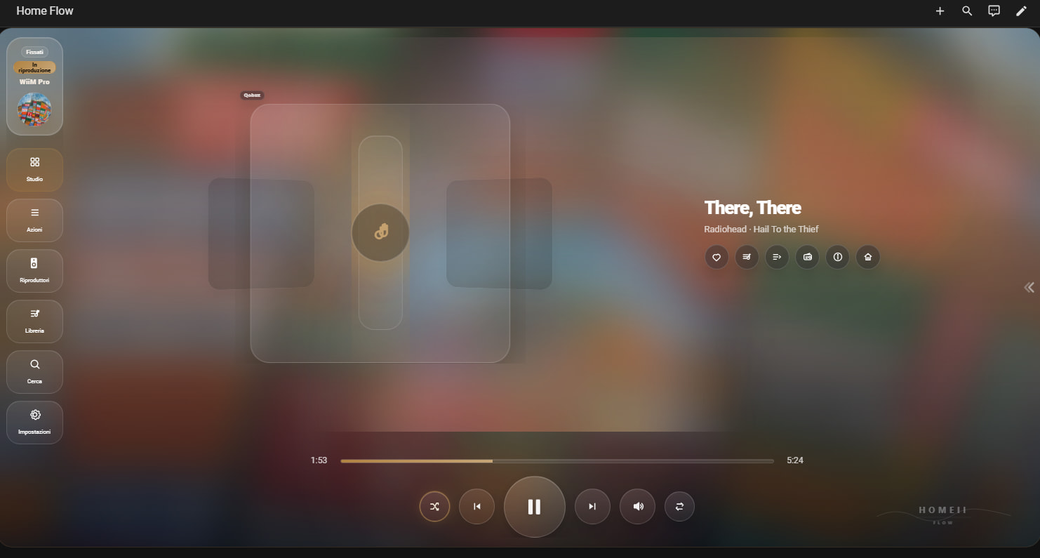

I've not tested much yet but have the following quirk:
On my desktop on Chrome I had HA running locally and your card was a subview in a masonary card layout. It looked great when editing with action, player, library and search along the bottom, but when saving and then pressing OK to save the dashboard, the bottom line disappeared and it's like a mini-player, only volume, pause, skip etc. Worse, when I pressed the full screen button, it started flashing on and off, on and off, it was tough to hit the X button to stop it.
Then for fun I changed it to a Panel card layout, and not only did it fix the problem, but in a lovely different view with buttons down the left side.
On my Android phone, there is no problem with either card view type. So something is weird. I'd appreciate a recommendation as to which type of card layout is recommeded.

For the best HOMEii Flow experience, I recommend using it in a dedicated Panel view with a single HOMEii Flow card. That is the most stable layout and the one the larger dashboard/player experience is mainly designed for. In that mode, the left-side button layout you saw is expected and is currently the best desktop/tablet presentation.
Sections view can also work well if HOMEii Flow is placed in a large full-width / full-height section, ideally as the main card on that page.
Masonry can work, but it is more fragile because Home Assistant may give the card a different available height after editing/saving the dashboard. That can make the card think it has less space and switch into a mini/compact player. The fullscreen flashing sounds like a desktop Masonry resize/rebuild loop, so I’ll treat that as something to improve.
My recommendation:
  • Use Panel view for a dedicated music dashboard.
  • Use a large Sections view layout if you want more dashboard structure but still want HOMEii Flow to receive most of the available space.
  • Use Masonry only when embedding HOMEii Flow alongside other smaller cards.
For kiosk, tablet, and desktop music dashboards, I recommend Panel view first, or Sections view with full width and height.
About settings: dashboard YAML/card configuration is global for that card/view. Many in-card appearance and behavior preferences are saved locally in the browser/app, so they can differ per device or browser. Home Assistant entity-based settings and selected players may be shared depending on your configuration.
Good catch. On phone layout, Studio is currently not shown as a main mobile shortcut. The Studio/left-side navigation experience is mainly part of the larger tablet/desktop layout, which is why you see it in the browser on desktop but not on the Android phone.
Queue, however, should be available on mobile if it is enabled in the mobile quick actions/settings. If Queue is missing too, please check the in-card mobile settings and make sure the Queue quick action is enabled.
So the short version is: Studio is currently tablet/desktop only, while Queue should be available on phone layout depending on your mobile settings.

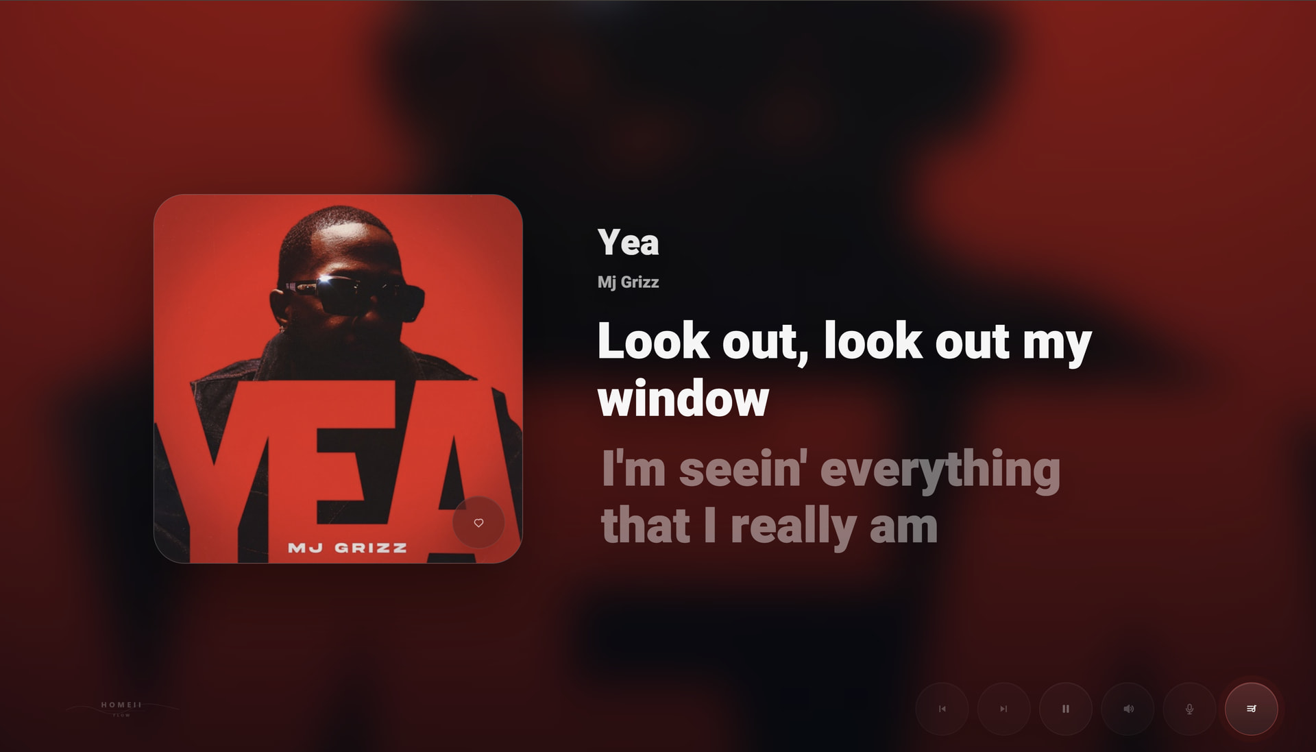

What if your Home Assistant music card stopped feeling like a card?
HOMEii Music Flow 5.8.0 is out.
This is not just another small bug-fix release. It is a big step toward making Music Assistant inside Home Assistant feel like a real music experience: polished, fast, touch-friendly, beautiful on wall tablets, and much better on phones.
What’s new:
  • Smarter mobile and compact layouts
  • Lyrics inside the screensaver
  • More stable artwork, queue, and now-playing transitions
  • FLOW Wizard for easier music discovery

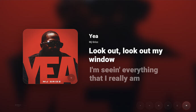

  • Sharper Flow Assistant matching, including Hebrew-friendly requests
  • Built-in Sendspin browser player support
  • Better library search and album/artist/playlist detail pages
  • Cleaner architecture, broader tests, and a HACS-ready release package
If you use Home Assistant, Music Assistant, wall tablets, or just want your home music dashboard to feel more premium, this one is worth checking out.

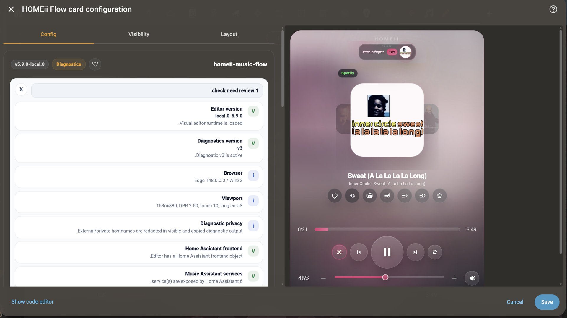

Why i cannot see the cover?
**Please update to version 5.8.2 beta 7 please don't select beta8! VIA HACS
If you are still experiencing the issue after updating, there is a new built-in diagnostics mode available in this version—please run it and paste the results here so we can look into it.
As a side note, a major new version (5.9.0) will be officially released later today!
