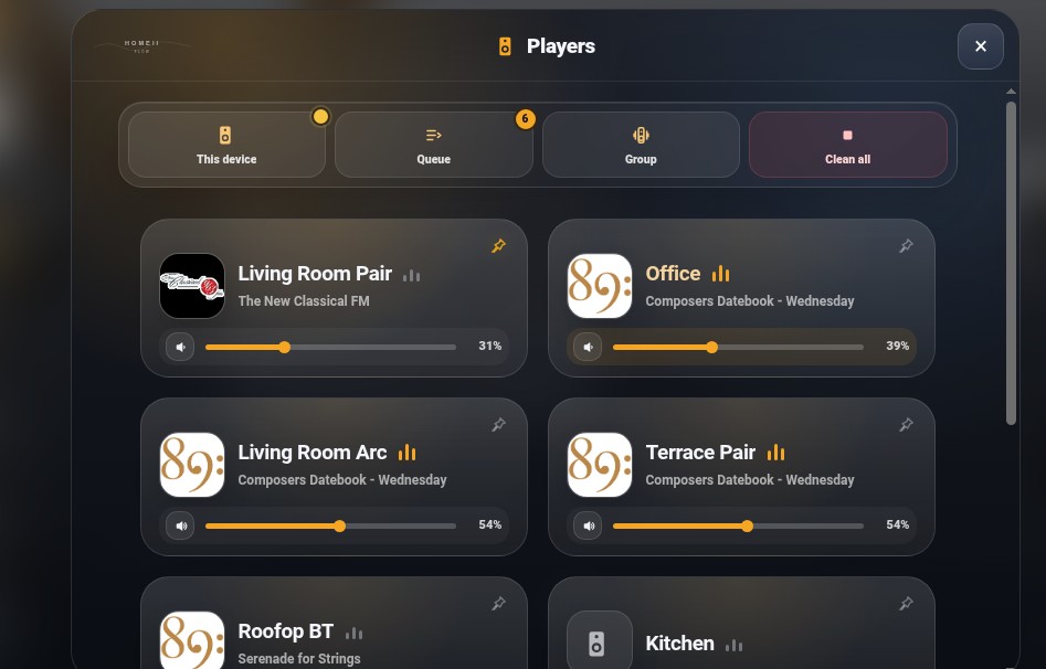

I select living room Arc and select radio station and play. I then go into the current program on th eliving room Arc, and use the Group button. I add kitchen and Terrace and Living Room Pair by pressing the plus signs beside those speakers and then at the bottom, APPLY GROUP.
Now I want to remove the terrace as I'm no longer outside. I click on terrace pair, and it reverts to the + sign. Yet the terrace speaker is still playing, so I figure I need to APPLY the change. So, I have 2 choices at this point. UNGROUP, which ungroups them all, and APPLY GROUP. That's the logical button, because it should change to remove the terrace speaker. It doesn't. It still plays.
It also still shows 4 speakers. Actyually 5. It seems to have added OFFICE on its own. So I click office to get the plus sign back, and it goes down to showing 2 playing, Living Room ARC and kitchen. But there are 3 lit up. It's making it unusable in daily use.
I'm concused about the highlighting to ORANGE, is that playing? Yet some are orange with the plus sign showing, indicating that they are not playing.

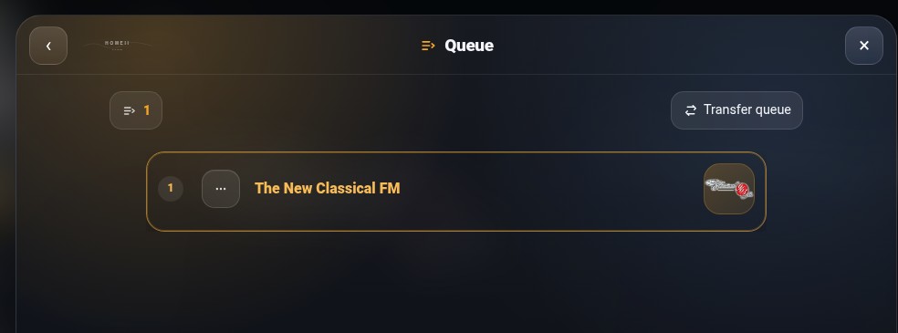

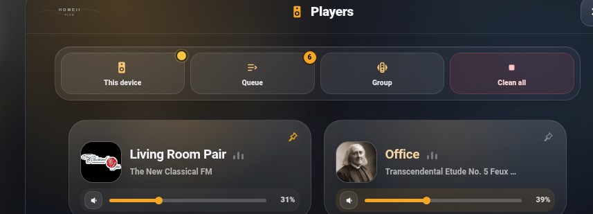

The queue also confuses me. It often shows with the number 6 beside it when there is nothing in the queue. I've attached 2 screenshots.

I just deselected all. Selected ONLY office, played the selection, a radio station, and take a look...it paired 2 others?

Thanks for the detailed report. I agree with you: the grouping UI is not clear enough right now, and from your description this does not sound like only a misunderstanding.
I think there are two issues here:
  1. The group screen is confusing visually. The orange highlight, plus sign, selected state, playing state, and current group membership are not clearly separated enough.
  2. More importantly, “Apply Group” may currently behave more like “add these players to the group” than “replace the current group with exactly this selection”. So when you deselect Terrace and press Apply Group, HOMEii may not be explicitly removing Terrace from the existing group.
That would also explain why the visible selected/playing count can become inconsistent.
I’m going to review and redesign this flow so it behaves more predictably:
  • Apply changes should make the real speaker group match the visible selection.
  • Removed speakers should actually be unjoined.
  • Current group members, pending changes, and currently playing speakers should be visually distinct.
  • Group/player counts should refresh correctly after changes.
  • The queue badge also needs a review, because it should not show a stale count when the selected queue is empty.

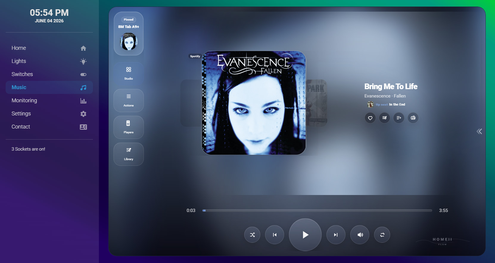

hi @RaA11
just wondering if it is possible to have this player full screen and occupy the remaining space on the right part of my dashboard?
thank you :slight_smile:
Wow, your dashboard looks absolutely beautiful! To be honest, I haven't personally tested it in a layout like that yet, but it looks amazing.
You should definitely try setting that specific dashboard tab's View Type to Panel (1 card). In Home Assistant, the Panel mode forces a single card to stretch edge-to-edge and occupy 100% of the remaining width and height, which is exactly what you are looking for.
Give that a shot and let me know if it works for you!

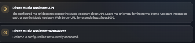

I am getting this error but don't know how to fix it:
This warning means the value you entered in ma_url is not the direct Music Assistant API.
If you are only using normal HOMEii playback through the Home Assistant Music Assistant integration, the easiest fix is:
  1. Open the HOMEii card settings / YAML.
  2. Clear ma_url.
  3. Clear ma_token.
  4. Save and refresh the dashboard.
HOMEii does not need ma_url for normal playback, library, queue, and player control through Home Assistant.
Only set ma_url if you want Direct Music Assistant features, especially “This device” / Sendspin browser playback. In that case it must be the direct Music Assistant Web Server URL, for example:
ma_url: "http://homeassistant.local:8095"
ma_token: "YOUR_MUSIC_ASSISTANT_TOKEN
Do not use:
http://homeassistant.local:8123
/music-assistant
/d5369777_music_assistant
.../ws
Those are Home Assistant / ingress / websocket paths, not the direct Music Assistant API.
If your Home Assistant dashboard is opened over HTTPS, the Music Assistant URL also needs to be HTTPS, or the browser may block it.

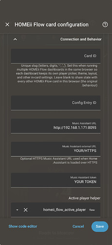

Actually i have this in the options:
config_entry_id: ""
ma_url: 192.168.1.24:8095
music_assistant_external_url: ""
ma_token: XXXXXXXXXXXXXXXXXXXXXX
Is this correct or not?
And if i wanto to use sendspin what and where to change ?
