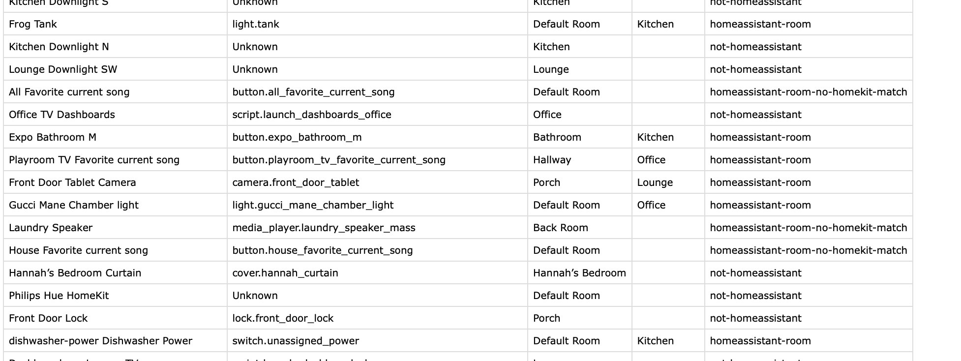

Example:
$ scripts/manage_homekit_rooms.py
Wrote plan CSV: artifacts/homekit-plan-20260312-223133.csv
Accessories scanned: 201
Planned moves: 8
Dry run only. Re-run with --apply to move accessories.
$ ./manage_homekit_rooms.py --apply-plan artifacts/homekit-plan-20260312-223133.csv
Loaded plan CSV: artifacts/homekit-plan-20260312-223133.csv
Rows in plan: 99
Planned moves: 8
Moves applied: 8
Wrote snapshot CSV: artifacts/homekit-snapshot-20260312-223725.csv
