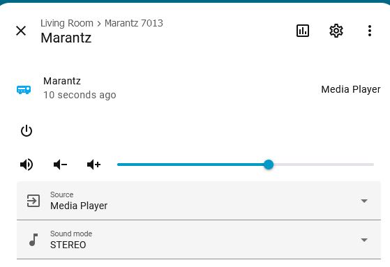

Here are the controls in HA:
You can see that volume, source, mode and on/off are all exposed to HA. Only on/off and source show up in Homekit.

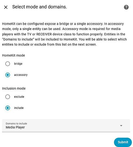

Here are the settings in the Homekit bridge integration.
Since it is a receiver I chose accessory per the instructions.

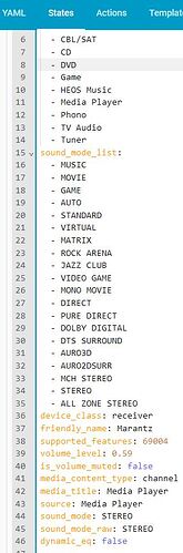

Could you locate your media player’s entity ID in Developer tools → States, and paste the value of the supported_features attribute?
To get the entity ID, click the gear icon on the top right of the dialog with the volume slider and look at the fields towards the top of the settings dialog. It should be of the form media_player.________.
This is way above my pay grade but when I go into developer tools and States (and turn the receiver on) I see this (the very top is cut off but it is just part of the source list):
The “supported features” just says “69004”. The only volume reference I see is showing what it is set to. What do I do with this?
I asked for that info because I thought maybe there is an issue with how the Denon integration was creating the Media Player, but as far as I can tell, the bridge should be exposing the volume controls to HomeKit.

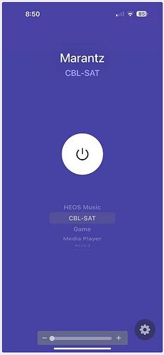

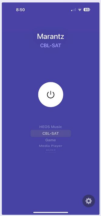

Alright, now this is bizarre. Maybe you have an explanation but I don’t. I took a screen shot of my phone to post here showing that there is no volume control and e-mailed it to myself to paste a snip here. The screen shot in the e-mail of course shows that there is no volume control except when I put my mouse cursor over the screen shot the volume control suddenly appears.
Its like the volume control is there but invisible unless I place my mouse cursor over it. I cannot make the volume control show up on my phone screen and nothing seems to happen when I put my finger over the “invisible” volume control.
Any ideas?
Assuming that’s a screenshot of the Home app, iOS bug.
Yes, its a screen shot of the IOS Homekit app but what is doubly strange about this is that it is just a jpg shot of the screen, it is not the actual app screen. I have never seen a jpg change just because a mouse cursor is placed over it. Its like placing the mouse cursor over the picture causes an invisible element to appear.
Yeah, and that even calls into doubt the iOS bug theory. It would be a much clearer situation if the screenshot had the volume control plainly visible and the app didn’t. What you’re describing really doesn’t make any sense.

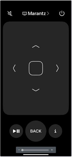

For what it’s worth, I’m able to control my receiver volume via the HomeKit bridge integration. But this is not possible in the Home app, which only displays a power button. You have to open the Remote app and select your receiver from the dropdown as if it was a TV, then click the up/down buttons on the side of the phone which makes the volume controls briefly appear. Note this is using IR control, where 0-100% slider would be impossible; I wonder if native network volume slider works differently.
Well that’s interesting. Does yours look like this:

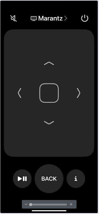

I also noticed that, like the home app, the volume slider at the bottom only shows when I hover my mouse over the jpg snip. You cannot see it on the iphone screen.
I think I have concluded that the Homekit Bridge integration is just wonky. HA needs to create a real Homebridge integration that actually uses Homebridge and has the same capabilities with plugins etc.
Yes, except I don’t have the -/+ slider at the bottom. When I click the volume buttons on the side of the phone, they show gray lines briefly beside the buttons (but cannot show up in screenshots which use those buttons). The volume slider that appears in the Home App for Apple TVs and HomePods appears to be for specific (Apple-only? AirPlay?) media players.

Thanks. Would you mind trying an experiment? Take a screenshot of your phone like the one above, e-mail it to yourself, open a preview of the screenshot in your computer and run your mouse cursor over the jpg screenshot. Does the volume slider magically appear at the bottom?
I was not aware of the limitations on the Denon plugin for Homebridge. You may be right that it is an Apple limitation. I agree about the UI on the Homekit bridge. Unfortunately I am not YAML literate.
