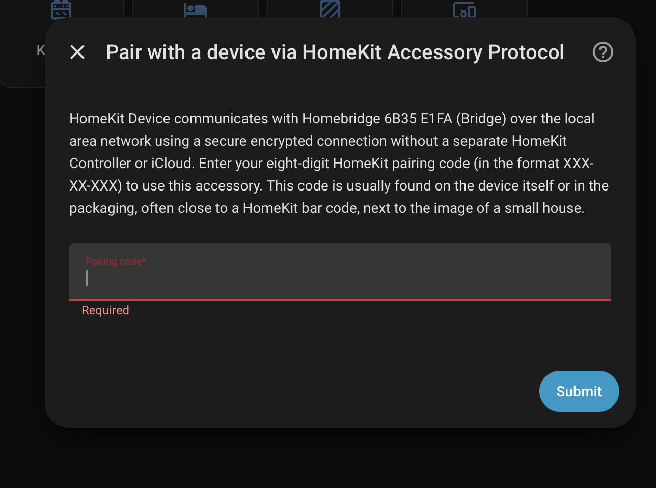

Hi. I feel like I’m missing something… most likely between my ears. HA readily detects the HomeBridge device (which I am assuming is my HomePod mini.) I would like to use this integration. When I try to, I get this:
For the life of me I can’t figure out where to find this. There is nothing of the sorts printed on the HomePod itself. Perhaps my google foo and forum foo is nothing but poo.

It’s easy to get confused regarding the Apple ecosystem and HA. The HomeKit Bridge is an integration that allows you to add HA entities/devices into Apple HomeKit where you can access them in the Apple Home App.
The HomeKit Device integration does the vis a vis vice versa, allowing you to add “works with Apple HomeKit” devices into HA.
The HomePod is an Apple Hub, which you will need to use the HomeKit bridge integration.
Regarding the discovery of a HomeKit bridge you are getting… that could be something like, for example, a Roku in the household that is broadcasting discovery packets to be added to Apple Home.
EDIT - If it’s the HomeKit Device integration that is being discovered, it probably is your HomePod mini, BUT… BIG BUT… if you already have the HomePod mini setup for Apple Home, you won’t be able to add it to HA. HomePod’s can only be connected via the HomeKit protocol to one setup at a time. If this is the case, and you really want it in HA, you can remove it from Apple Home, add it to HA with the HomeKit Device integration, then use the HomeKit Bridge integration to add it back to Apple Home as a media player. However, this will render it’s hub capability to zilch. You’ll need another HomePod device or an Apple TV to act as the hub. This is my assumption, though tbf. I don’t have a HomePod device, but I do have an Apple TV.

It depends on what is actually being discovered in HA. Does it say “HomeKit Bridge”? Or does it say “HomeKit Device”? Once that is figured out, it comes down to what it’s actually for.
But we need to take a step back. Have you setup a “Home” in the Apple Home App? If you want to use HomeKit Bridge to send HA entities to Apple Home so you can turn them on/off in the Home App and use Siri to turn them on/off, then you have to setup a Home in Apple’s ecosystem.
HI! It says “Homebridge 6B35 E1FA (Bridge)”
