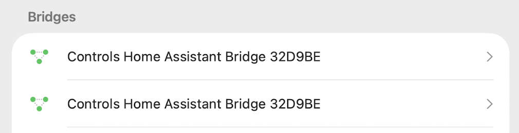

Lately I’ve had a weird issue where all of a sudden HomeKit will report that there are two HomeKit bridges from HA, both with the same name. This wrecks everything since it make some/all of my entities show up in HomeKit as “unsupported” and all of their controls stop working. If I try to delete one of the bridges from Apple Home, they both get deleted and all of my entities disappear. Then I had to re-add the bridge to Apple Home, move 50 or so devices back into the proper rooms, and wait for this all to happen again down the road.
