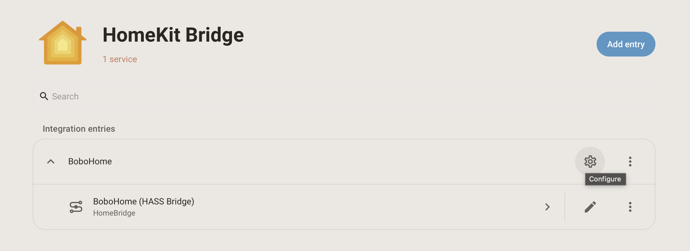

Chose the gear icon

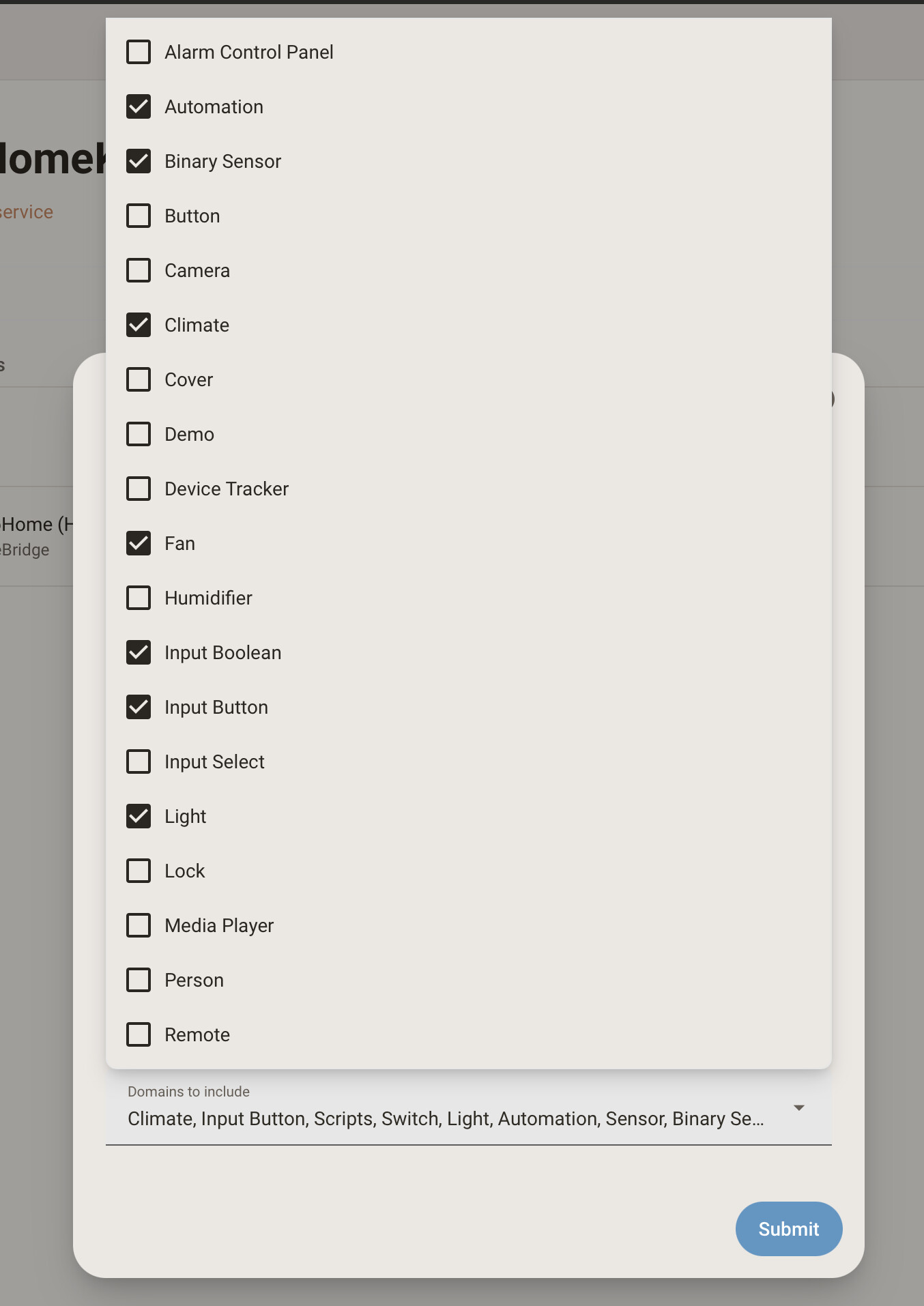

You _should_ see your previous settings. Click on the ‘domains to include’ drop down, where you can select your additional domain (switches) to include.

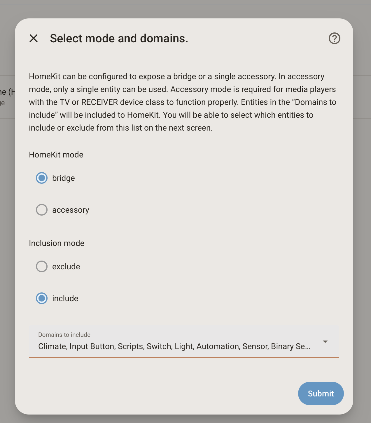

With those steps, are you able to get to this point where your previous selections are still intact? (once your next domain(s) is(are) selected you’d press submit and add the devices)

When I started out (coming from Hubitat too) I selected “Bridge” and “Include” on the “Select Mode and Domains” dialog when I started with this, and it’s always showed what I’ve previously selected when I return to add/include more devices. You shouldn’t need a HomeKit.yaml. If I were in your shoes I’d remove the HK integration (and homekit.yaml) and start over by reinstalling the integration (as a matter of fact, I think I did that due to initial confusion with what that dialog).
