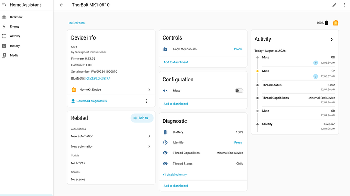

On Home Assistant I successfully connected a home-kit only thread doorknob: Thorbolt MK1, but when I sync thread credentials to it, trying to lock and lock the doorknob remotely doesn’t work. Everything else works: when I click identify the doorknob beeps 3 times, and beeps when I toggle muting. Locking and unlocking only works if I don’t sync thread credentials (apparently its then only connected via bluetooth).
I tried restarting home assistant and unplugging my thread router (SLZB Ultima) for 30 seconds, and I still have the issue, when I did I watched the doorknob go from unconnected to HA to connected.
