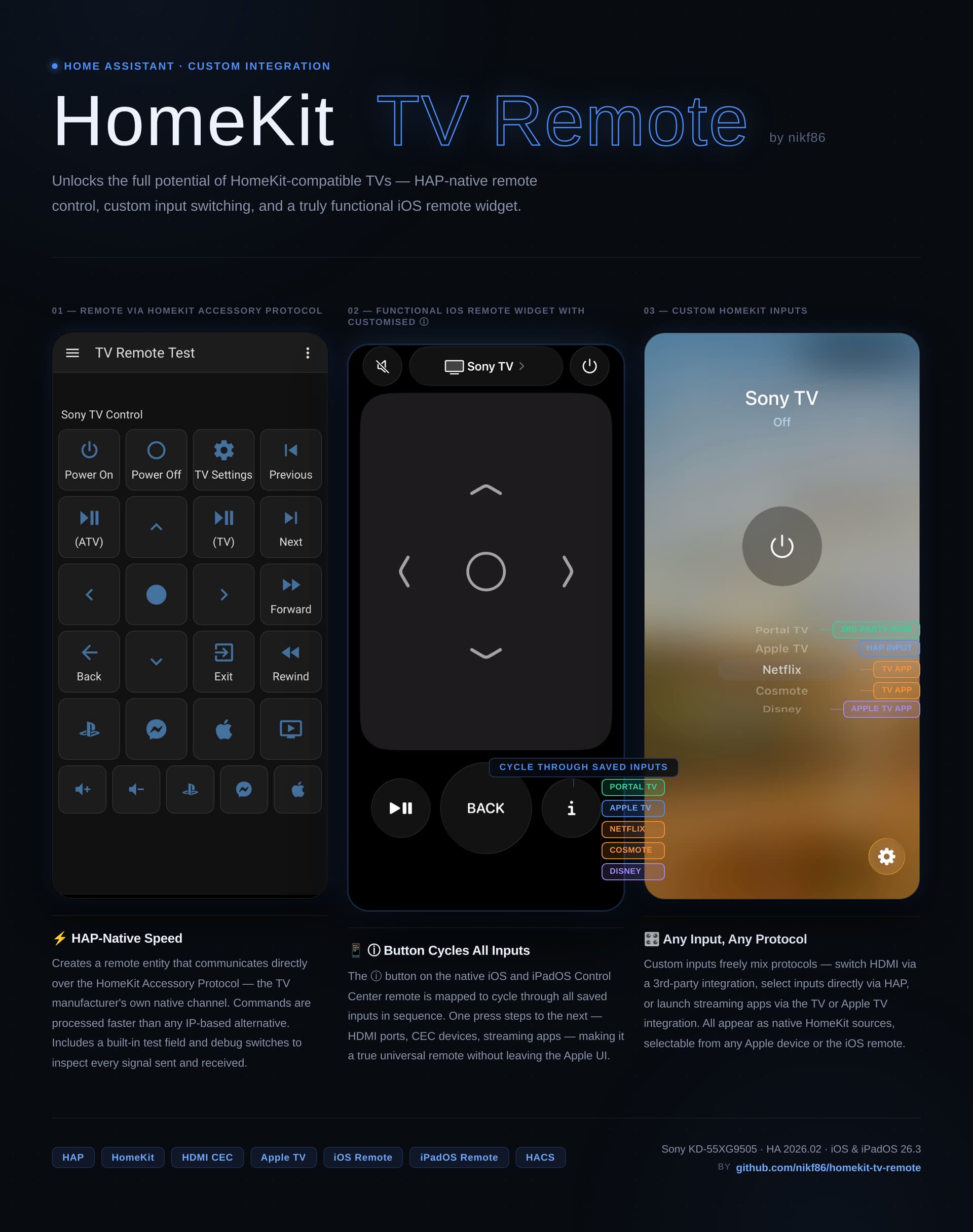

  1. It creates a remote entity which works via HAP protocol
The remote control is very fast compared to other IP-based methods since it uses the official Apple protocol which is prioritized by TV manufacturers. A test function with debug options has been implemented.
  1. Custom TVInputs in HomeKit
It allows you to create selectable inputs in Homekit based on HAP protocol and 3rd party integrations to set the HDMI input, open apps or practically add any TV command
  1. Customized iOS remote
In iOS remote the ā€œiā€ button has been mapped to cycle through all saved inputs (as highlighted above) making the remote functional across all HDMI-CEC connected devices
It has been tested so far with Sony X950G and I look forward getting feedback from owners of other brands of Homekit compatible Tvs.
