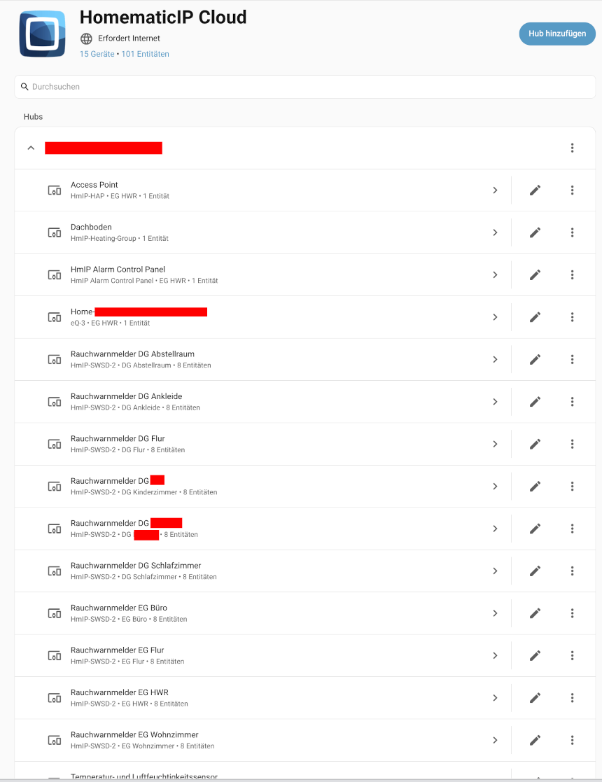

Which integration did you use:
Did you see any activity, related to the incident, in one of the entities?
If so, and you used the right trigger in your automation, it should work.
