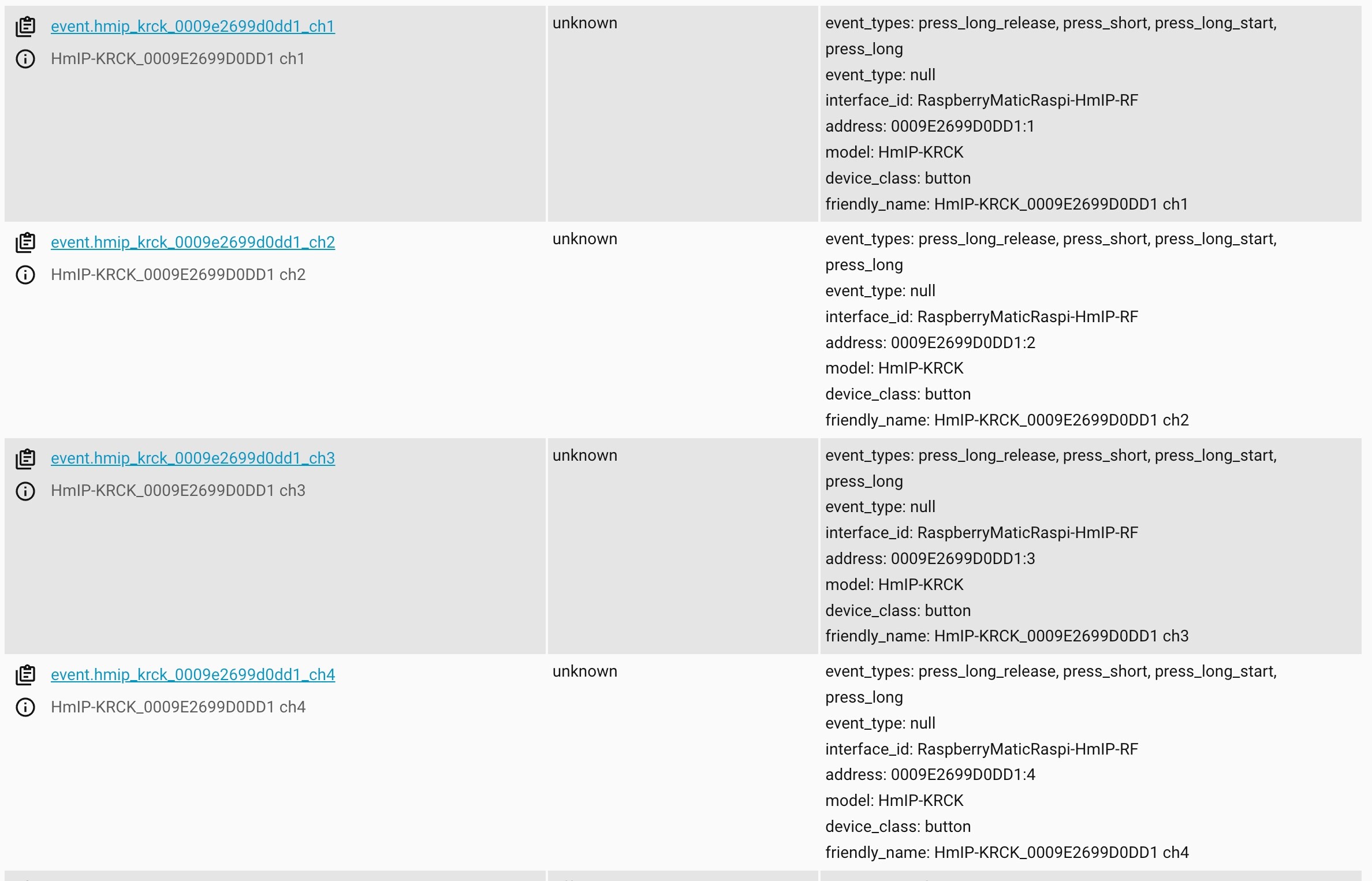

I adapted it to raspimatic, and there every keypress works, as seen here:
But in developer tools in HomeAssistant the relevant data is not updated:
any idea what else I have to do? I cannot remember that anything “special” needed to be done for the floor heating.

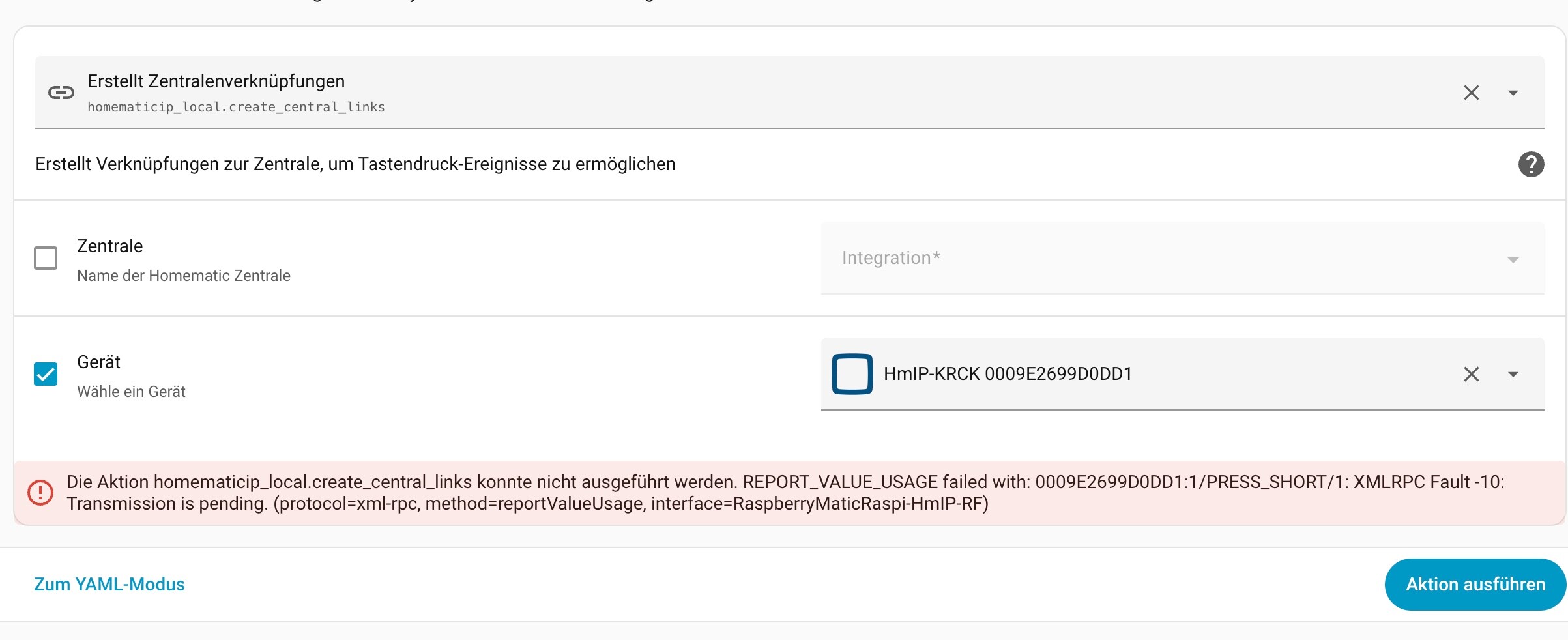

I found that I have to activate the buttons like here described
but get an error:

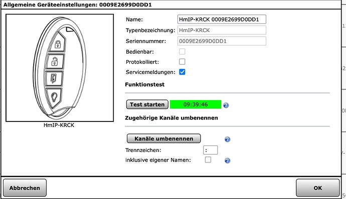

After the call I went to the CCU (raspimatic) and than devices → krck I than could transfer something, and since than the keys work.
If I see it correct, you have to activate each key. I first hat only three keys running, because I (for what ever reasons) I tried
developer tools -> actions homematicip_local.create_central_links
three times, and acknowleded all in the CCU.

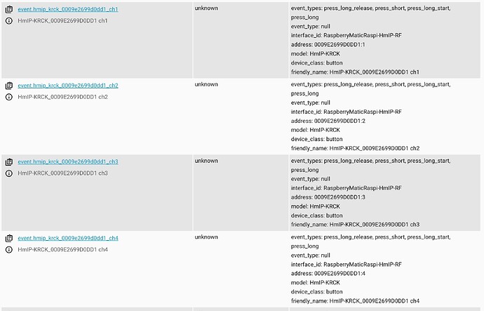

But this might be a wild guess from me. Fact is: I only had key 1-3 than I retried the above command in developer tools in HA and acknowleded it in the CCU and than I had 4 keys.
