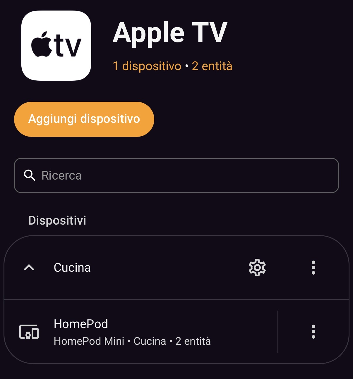

The HomePod is connected to the network and in HA with the integration Apple TV as follow:
the problem is that sometimes it disappears completely as a border router, sometimes it comes back and works, sometimes it comes back but the connected devices (Matter over thread) are offline.
