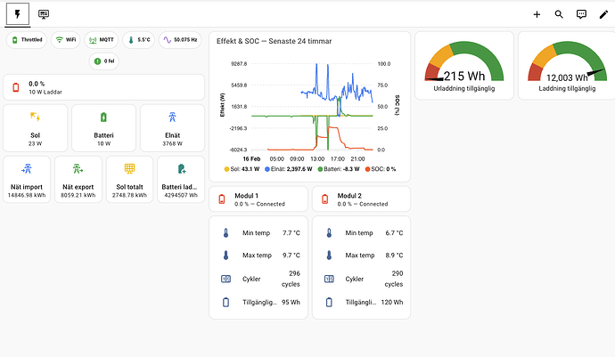

I’ve built a custom integration for the Homevolt battery system (Tibber / Polarium) that provides comprehensive local monitoring via HTTP polling – no cloud required.
Why another Homevolt integration?
There’s a core integration that was recently merged, but it only polls 2 API endpoints and creates ~32 sensors. My integration polls 6 endpoints and creates 114 entities covering everything the battery exposes.

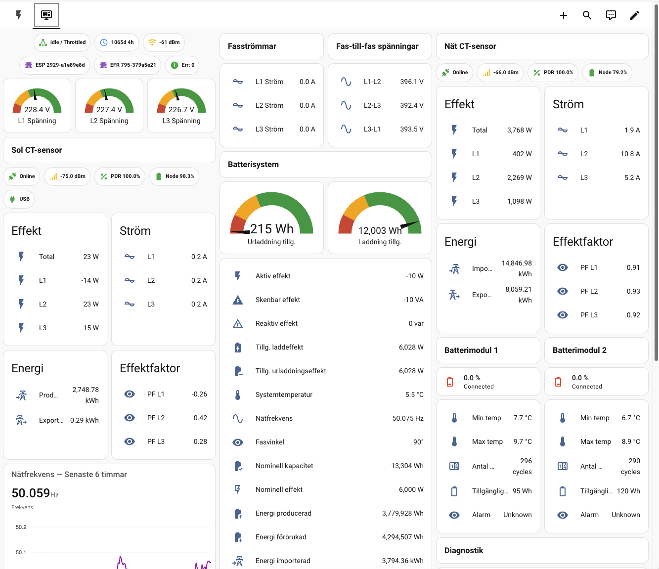

What you get
  • 19 system sensors – power, SOC, energy produced/consumed/imported/exported, temperature, frequency, phase angle
  • 6 voltage + 3 current sensors – per-phase L1/L2/L3 plus line-to-line voltages
  • 14 BMS sensors – per battery module: SOC, temperature, cycles, energy, alarms
  • 36 CT clamp sensors – per-phase voltage, current, power, power factor, RSSI, PDR, frequency
  • 12 CT node sensors – battery voltage, temperature, uptime, firmware, OTA status
  • 6 schedule sensors – current action, next action, entry count, local mode
  • 6 diagnostic sensors – error report summary, EMS info/warnings/alarms, firmware versions
  • 5 status sensors – uptime, WiFi RSSI, firmware ESP/EFR, error report health
  • 9 binary sensors – WiFi/MQTT connected, CT available, USB powered, firmware update available, schedule local mode

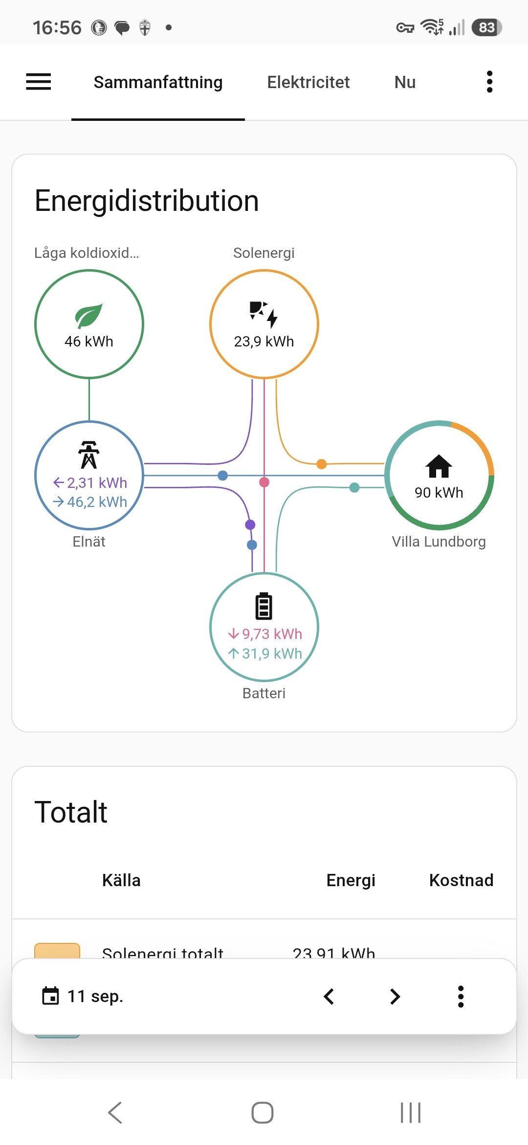

I don’t know if this is an open question for you, but yes it does.
I’m running a dual pack setup with no major problem.
The one problem I do observe is that the energy dashboard get the network frequency support wrong as the maths does not add up correctly
HA believes that the household consumes 90kWh, the true value should be in the 30kWh neighbourhood.
