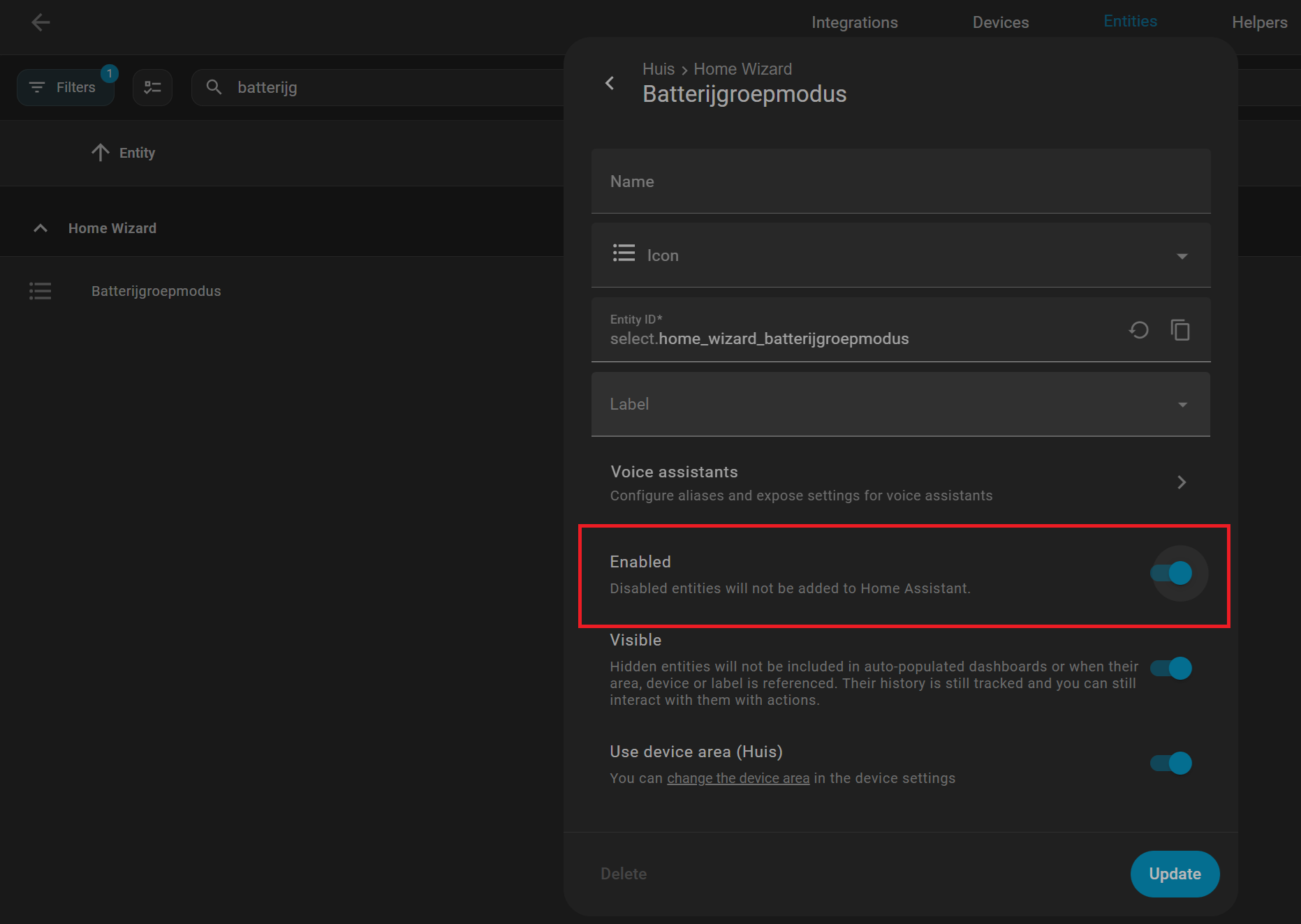

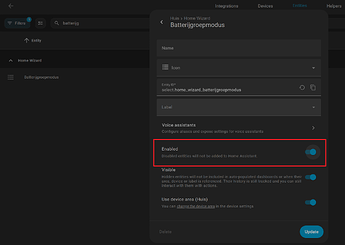

You can set the mode directly in Home Assistant without needing to configure the REST API. You can automate this by calling the select.select_option action.
Thanks… The documentation is a bit fragmented so here is my step-by-step for others.
Got it working by enabling the Batterijgroepmodus entity. (Settings / Devices & Services / Entities → Remove filter for Enabled entities and search and open batterijgroepmodus → click the settings wheel and enable the entity)
After this you can use the entity in an automation like this:
